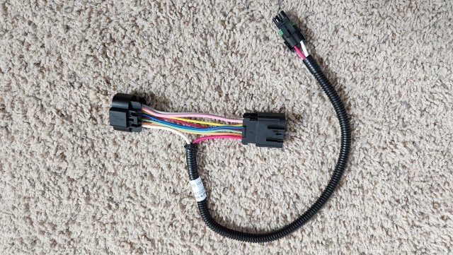

I haven't tried unplugging the relay directly but any break in power to the JMS shuts it all down. JMS gets power from both FPCM modules through a simple 2 pin connection, +12V in then sends that out as an increased voltage you specify to the pump. Unplugging either of those shuts everything off.
One of these plugs directly in to each FPCM then the 2 pin white/red connectors go to the JMS box. Red is +12V and White is output to pumps. As you can see everything else is straight pass through form harness to FPCM.
Right now I just have the JMS connected to one FPCM and it's working fine but only on the one pump. Putting it on both will be better as I can give each pump a little voltage instead of all the increase on just one.

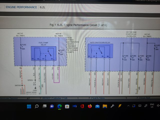

your second relay that controls ground for first relay could get its coil side power from tapping into fuel pump relay or auto shut off relay in trunk fuse/relay panel. pin 87 on either
very simple easy, safe circuit to wire.
7,305
19,148
Thread Starter #32
I understand what you're describing. What does the auto shut down relay actually do?
I'm going to try removing the unused wires in the JMS connector first and keep that 2nd relay as an in my back pocket option.

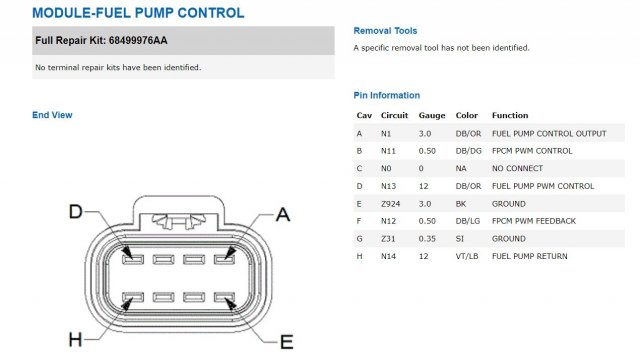

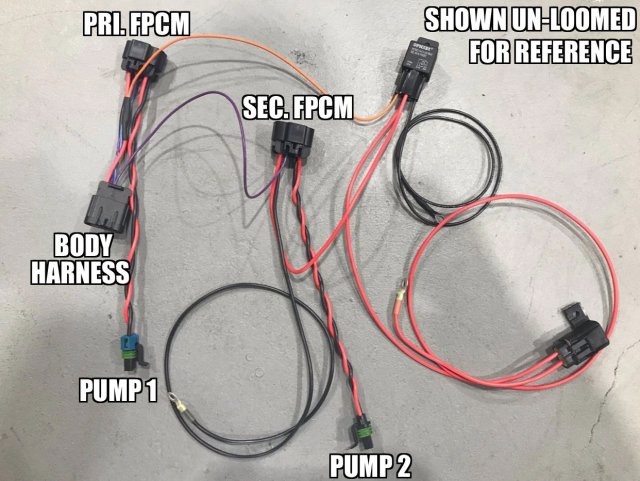

Looking at the dual pump harness:
FPCM 1 connector has this configuration:
PIN A +12V from fuel pump relay output as described in the wiring diagram. The external relay for the dual pump system is also activated from here.
PIN B goes to PIN B on FPCM 2 connector. This is the PWM Control and makes sense to keep both pumps in sync with the variable voltage they see. This wire is purple.
PIN C NO CONNECTION
PIN D I believe this is the +12V out to fuel pump 1
PIN E Ground
PIN F PWM feedback this wire is blue. This also makes sense as this is the feedback loop back to the PCM telling it the commanded voltage is being seen.
PIN G NO CONNECTION
PIN H This is another connection to fuel pump 1, the wire is black so likely the fuel pump ground or this is used to complete the pump circuit.
FPCM 2 connector is super basic and has the following configuration:
PIN A +12V from external relay shown in the harness above.
PIN B Purple wire from FPCM 1 and used to keep the pumps in sync I believe.
PIN C NO CONNECTION
PIN D fuel pump 2 +12V
PIN E Ground
PIN F NO CONNECTION
PIN G NO CONNECTION
PIN H another connection to fuel pump 2, the wire is black so likely the fuel pump ground or this is used to complete the circuit.
So there's several things not connected to FPCM 2 on the dual drop in harness, but the JMS has everything wired in theirs. I'm going to try removing the wires on each JMS harness that have no connection and test.
If that doesn't find the problem then it'll have to be something internal to the JMS control box and I'll have to add a relay or diode somewhere.

auto shut down relay will cut power to several circuits if ECM does not see crank signal or RPM.
sort of a safety relay in the event of an accident.
sure you have noticed if you push start without your foot on the brake pedal the ecm will allow fuel pump to run for a few seconds. if ECM does not see crank signal ASD relay will shut things off.

Well, de-pinning the JMS harnesses to match the dual drop in system FPCM connectors didn't work. I was pretty confident in that so bummer.
It must be something to do with how JMS handles the voltage input/output from the Fuelmax and how the second FPCM is connected. As a hail marry I'm gonna see if I can easily move the +12V on/off trigger wire going to the second fuel pump to the factory fuel pump relay. Theory is that the second pump will only be active when the factory fuel pump is, and that'll remove that trigger from the FPCM connector.
If that ends up being a PITA or I don't like how the wiring is secured in that configuration I'm just gonna run it on a single pump until a solution is found. You'd think someone would have solved this by now.
