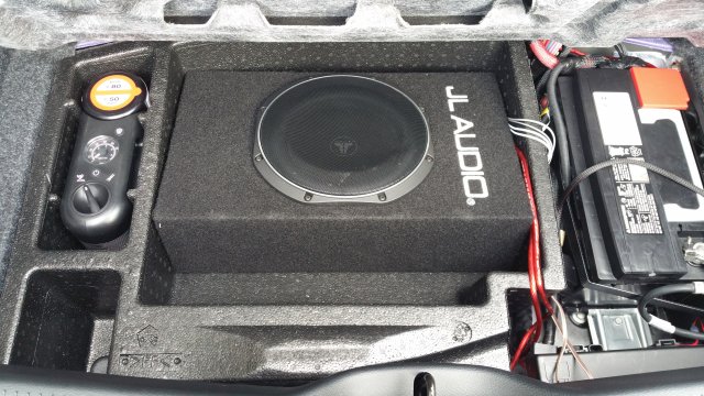

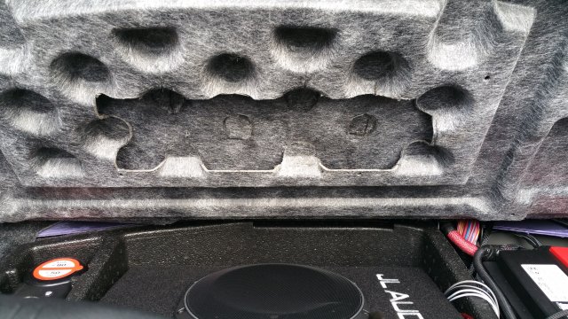

I am that JL acs110lg-tw1 in the trunk guy.
I tapped BOTH 6x9's in the back and have seen no degradation in performance or response. I can only surmise that the JL amp is somehow taking care of this internally.
The factory will roll off bass. I've experienced it. They will also roll off highs too but you wont care too much about that. A LC2i wouldnt hurt but I'm gonna be honest...if you get to the point its needed...its loud. REALLY loud. Coming from a guy that used to roll with 4 Comp 15's and 1100w in his deville.
NOTE: I have the base alpine audio.

A little update:
I completed installing the 10" JL ACS110LG-TW1. Set the turn on to DC signal (using high level inputs) and the amp does seem to turn on and off as desired without the need for running a remote trigger. It likely would be easy to use a power on ignition from the nearby fuse box if a remote trigger was desired.
I used the HK center woofer to tap signal and soldered the positive wire to both LH and RH positive high level inputs on the JL wire harness. Did the same to the negative. I think the amp would sum the inputs if it was driven by a stereo source but I was worried that if I only fed one side (like used LH but nothing on RH) that it might result in less power? Don't know if that would have been the case but splitting off into both seems to have worked out fine.
I cut out foam in the tire well and didn't trim the well cover in order for the cover to sit flush. I cut a hole in the side so I could lift out the foam well with amp in it and make adjustments easily (left some service length on the wiring to facilitate this). The amp fits very snugly and I didn't want to deal with the wires getting wedged in and possibly pulling on the connections when installing or removing the sub. JL provides a nice plug for the power, ground and remote wire that can be easily removed through the hole. The high level inputs also have a plug with a wire harness. It would only take a few moments to disconnect and remove the sub if desired. I used inline taps on the center HK woofer wires and left the speaker unplugged. If desired this will all be very easy to put back to stock with nothing cut or permanently modified except for the foam in the well. I took power direct from the batter post connector and for ground used a body ground that the battery ground goes to (so its basically direct to battery.)
I did nothing to provide better path for bass into the cabin like cutting a hole in the well cover and removing the factory woofer. I might in the future if it seems like more thump is needed.
I've only done a little tweaking so far with the crossover settings and the input sensitivity with surround off and the equalizer settings on the head unit set to flat. I also ended up setting the output polarity to 180 out as it sounded better. Who knows what HK did with the fazing so its nice that its just a flick of a switch to change it on the amp.
So, my initial impression is good. The install is easy with only the under rear deck cover requiring removal and its just held in by push pins. The wiring is minimal and all in the truck area. Easy return to stock if needed. No trunk space above the cover is lost. You can still get your factory tire inflation thing in its slot in the foam well. Cost, less than $600 for the sub and an amp wiring kit. As for sound, much better bass hit and much cleaner. I think the system does roll it off bass a little at full volume but its good enough for me. Its not going to rattle out your filings but its surprisingly good. I'll have to go on a nice cruise to evaluate further but its sounding good so far.

As for cooling, I'll have to see how it goes. There are no fans on the amp. The area that it is mounted in doesn't have a ton of space. I'm not very familiar with this type of unit or how much heat it might make. JL says:
__________
Amplified Subwoofer System with Single 10TW1-0.25 Subwoofer (Note: that is 1/4 ohm driver), Built-In 400W Class D Amplifier, Black Carpet - Sealed Enclosure
In PowerWedge+™ systems, the power is built right into the subwoofer system. Housing a proprietary Class D amplifier, this subwoofer system employs our exclusive DCD™ amplifier technology to extract maximum output from its specially engineered, ultra low-impedance TW1 driver. By combining direct power conversion with an ultra-high current output section, DCD™ amplifiers are free of conventional switching power supplies, enabling them to generate remarkable power with unprecedented efficiency.
__________
They say in the manual that the unit is up to 94% efficient and thus operates much cooler. It also says to install in a well ventilated area.
So, I guess I'll see if cooling is an issue. Fubar569 (above post) has this unit in the same place, hopefully he has had no issues? If there are issues, I could do something like Go Goody (above post with picture) did with a screen installed on the well cover. I also tend to worry about cooling and usually overdo electronic related projects with more cooling than likely necessary. Anyway, its a good point and I will have to see how it goes.

Same place.
No hole in the side.
No issues.
You can try to drop some bass blockers on the front door channels but if you cant get to the amp and need to pull the door card? May as well replace the speaker while you're there.

Took a few pics as promised: View attachment Side Cut.JPG
Access cut in the side of the foam insert, extra wire so insert can be pulled up for Amp adjustments. All wiring at the amp has plugs (a design feature of the amp) so a quick removal is possible with no loose wires floating around. The rearward floor (towards back of car) of the foam insert was shaved down so that the cover will fit flush as the speaker grill is too tall. Other option is to clearance the cover as shown by fubar569 in prior post.
This is the foam insert tilted up. This is all you need to do to make amp adjustments.
Shows wiring exiting the side of the foam insert with it lowered in place.
What it looks like all installed with the cover hinged up.
Installation completed and cover stowed.
