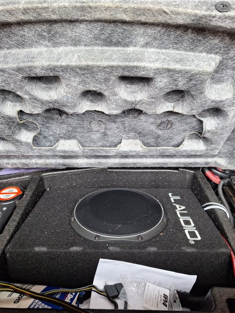

Longer term update:
I have been very happy with this install. I've got probably 10 hours or so in the car with this JL sub and have had no issues. No cooling problems so far with two hour stretches of moderate bass play. I've dialed my input sensitivity down to about 50% for nice bass but not overpowering amounts. I can now enjoy listening to music! Sounds like it should and much more like I would have expected from a nearly $2k upgraded audio option. Plenty of bass gets through to my ears so I don't plan on cutting holes in the tire well cover or removing the unused factory woofer in the center of the parcel shelf. Bass is just how I like it, clean and tight with no distortion. No rattles from the car and not overpowering. If you want more bass, it can do a lot more, its just a quick adjustment to the input sensitivity. I'm also happy that the head unit equalizer bass slider does have a decent effect on the subs output. So you can get a bit more or a bit less bass easily while driving.

Thank you! As fubar569 stated, it is a self powered sub as in the amp is integral to the box. Primary advantage of this option is simplicity. Normally self-powered options are not known to be particularly high quality. A complicated, expensive and more professional install would definitely include sperate amps. As I was only looking for improved bass and clean simplicity, this option worked out well. I like JL stuff and this self-powered little sub seems like a legit bit of kit. It sounds great and I don't feel like much was compromised. It fits well with no loss of trunk space! Wiring is very simple, power, ground, and high level input harness. Sorry I don't have a picture of the foam well without the self-powered amp in it.

I realize this is a almost four year old post but I am ready to do this same install with the JL Audio ACS110LG-TW1 in my 2023 Challenger Scat Pack with Alpine 10 speaker system. It's seemingly a very similar issue as the Charger HK set up with the 8 inch sub in rear deck that just doesn't do it for bass.
Question I have is the JL fits really tight in the Styrofoam liner. I noticed they all superceed to 05030175AF but this latest looks slightly different than your pictures. I still think it's doable but could use some advice on the amounts and locations you shaved, cut, deleted the foam in your install to obtain that below level clearance would be very much appreciated.
