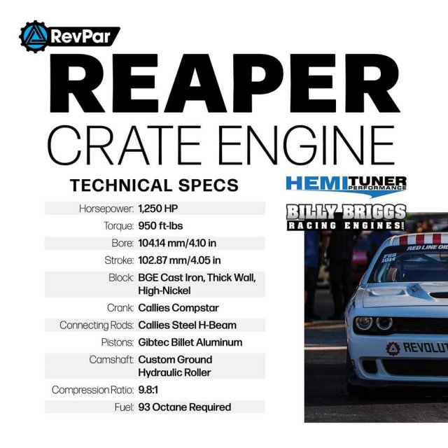

What’s this rev reaper motor.
While everyone is counting down to Christmas, we’re counting the reasons to love HEMI power! If you’re ready to experience the power and performance of a lifetime, look no further than the RevPar Supercharged 1,250 Horsepower Reaper Crate Engine. Here are 12 reasons we think you’ll love the RevPar Reaper:
1. Horsepower! The RevPar Reaper boasts an incredible 1,250 horsepower, ensuring that you’ll leave your competition in the dust.
2. Torque: With a torque rating of 950 ft-lbs, this engine delivers unmatched acceleration and power.
3. Bore: The Reaper features a 104.14 mm/4.10 in bore, allowing for optimal airflow and combustion.
4. Stroke: With a stroke of 102.87 mm/4.05 in, this engine provides a perfect balance between power and efficiency.
5. Block: The BGE Cast Iron, Thick Wall, High-Nickel block ensures durability and longevity even under the most demanding conditions.
6. Crank: Our Callies Compstar crankshaft is precision-engineered to handle the immense power output of our Reaper.
7. Connecting Rods: Callies Steel H-Beam connecting rods provide the strength and reliability needed for high-performance applications.
8. Pistons: Gibtec Billet Aluminum pistons are lightweight yet robust, contributing to the engine’s overall performance.
9. Camshaft: The Reaper comes equipped with a custom ground hydraulic roller camshaft, delivering smooth and consistent power throughout the RPM range.
10. Compression Ratio: The engine features a compression ratio of 9.8:1, striking the perfect balance between power and fuel efficiency.
11. Fuel: The RevPar Reaper only requires 93 octane fuel for optimal performance. Easy peasy.
12. Tuning: Whether you’re looking to fine-tune your engine for maximum horsepower or optimize it for fuel efficiency, the RevPar Reaper engine provides a solid foundation for any setup.
AND because you’ve been really good boys and girls this year, we’re tossing in an extra reason: We’re offering a 1-year warranty (complete engines only) and remote tuning on these complete engines to ensure that your Reaper engine and transmission are tuned exactly to your application.
We’ve got complete engines ready to move at $27,500. If you’re looking for long blocks, we’ve got you covered too at $23,500.
5,499
4,529
So it makes 250 more hp than a pulleyed e85 stock sealed engine stock 2.4

Blocks are 2900
Cranks 1100
Rods 1300
Pistons 1300
Machine work a grand
Gaskets 300
Oil pans 500
Timing cover water pump 1000
Balancer 500
Covers 800
Wonder what head studs he’s using and main caps.
this is what’s in mine without the aluminum block
Winburg crank 4000
Oliver rods 1200
625 rod bolts 650
Diamond pistons coated gas ports h13 dlc coated pins
2550
Custom cam 375
Johnson lifters 900
Manton push rods 3/8 to 5/16 taper 900
Thiteck heads titanium valves with inconel ex valves 3600. ( got a deal)
Manton roller rockers with covers 3500
Stef Deep aluminum oil pain 1000
625 head studs 1200
All arp stainless 12 point bolts used 450

Not impressed with parts list for 27,500$
@Hatermkr build is MUCH better

Never heard of the pistons he uses.
5,499
4,529
Isn’t gibtec the turkey organs you use to make gravy and stuff?

Are aluminum rods the preferred choice at ~1200hp?
29,574
131,087
I thought they are only good for about 50 passes?
3,288
10,443
I can say that the crank and rod package is certainly not what I would call “max”. Saved some money there. Apparently they feel that’s good enough at that level. It doesn’t say what the heads are. Ported HC’s? That 1250 is obviously at the crank. Even still… on pump. 😬. It does say high nickel block so they are acknowledging that all BGE’s are not created equal. The full crate is the better deal because the Whipple and the rest of that package is added for less than you could buy it for separately. Looks like that package also includes the tune and as long as you don’t do anything there, has a warranty. I can see that working for some.
29,574
131,087
I wouldn't trust running it on 93. Just my opinion.

I agree could do better for someone it’s a good deal just not for me
