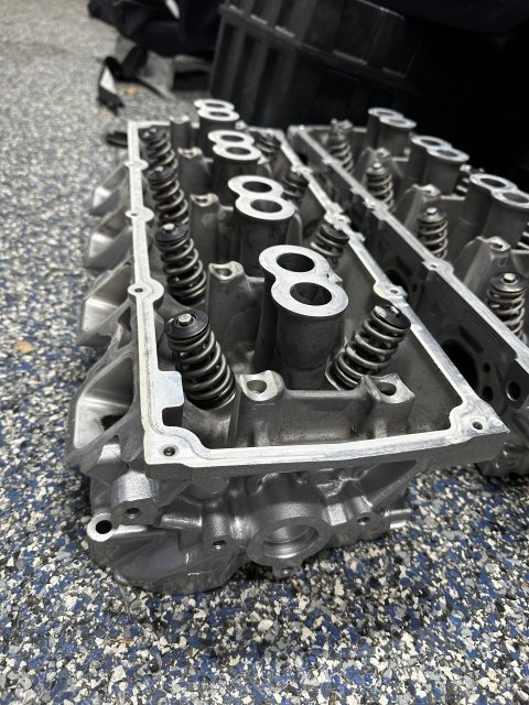

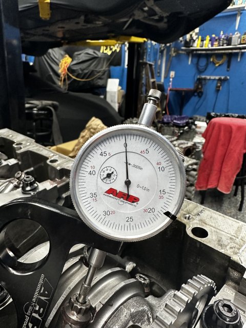

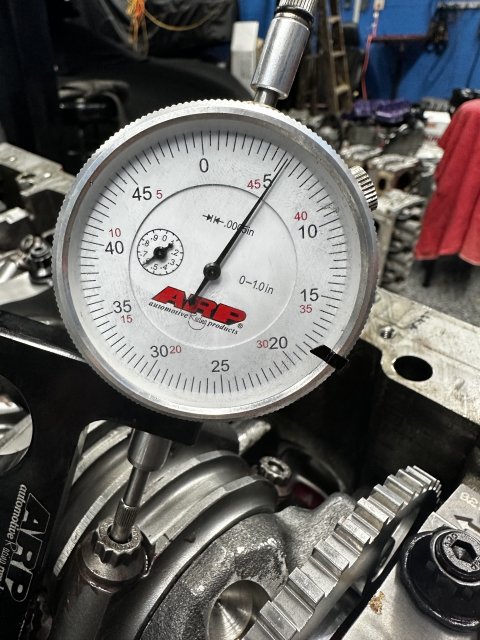

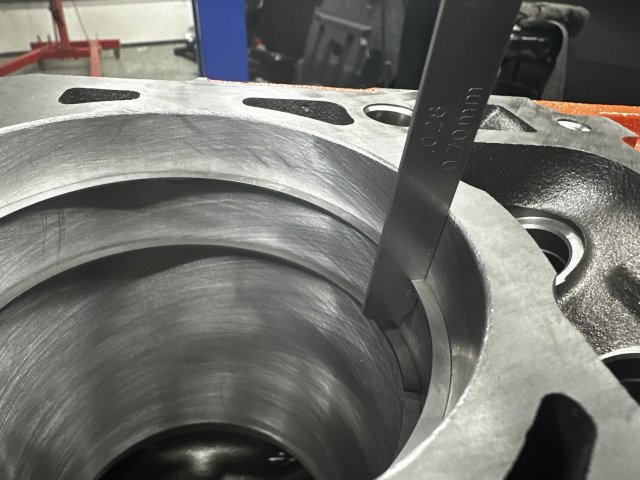

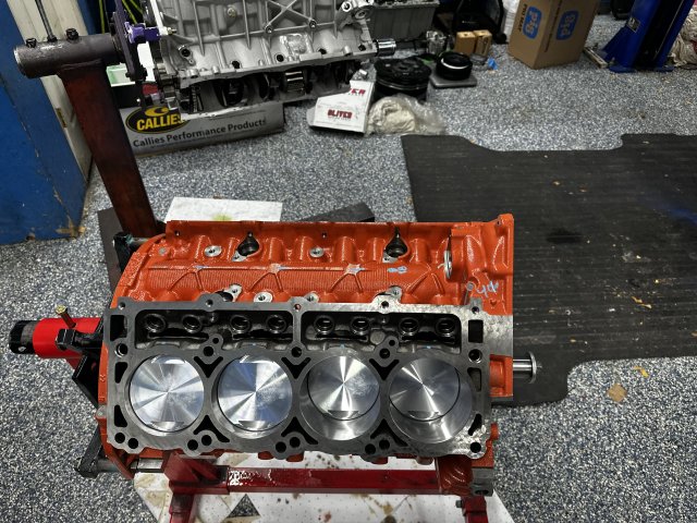

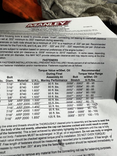

I told Cody I have him handled by Christmas. Changing to a new cam changed that hopefully new years. Got his short block together set of ported heads with valve springs. Was up @ 5 this morning to put pistons in but I will be happy to see him on the road again. IMG_8006.jpeg IMG_8005.jpeg IMG_8002.jpeg IMG_8003.jpeg IMG_8004.jpeg 72498755771__6B2C82C0-8C68-42A6-B1C6-F04F7AE3D953.jpeg IMG_7960.jpeg IMG_8007.jpeg

Cam is one Jon and cam motion spec out heads are a set of ported thiteks I had laying around
We are on a time frame with Cody’s.
