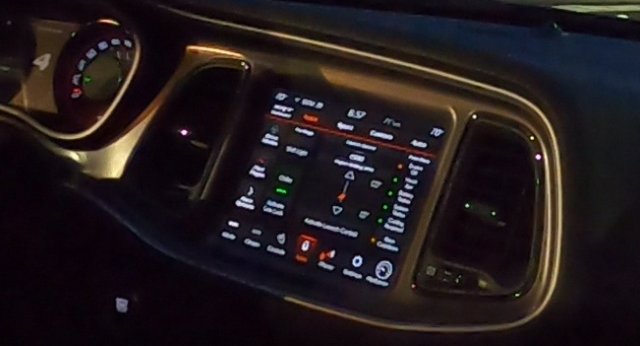

2 - Are you sure you had the chiller on? The overall of your run descriptions makes me think about my first outing. For me, letting the engine idle for at least 3-4 minutes with the chiller on nets my best results. That's been the case personally for three different cars now.

2 - chiller green light was on... Also notice when I do this that my "auto" light comes on for the climate control--is that right? I turn climate control off on the knob, but when I hit the chiller button the green light comes on and the "auto" illuminates. You can see it in my video, and below is a blown up shot of my chiller button.

Chiller on, I took this from my gopro and tried to zoom in so you could see the green light: chiller on.jpg

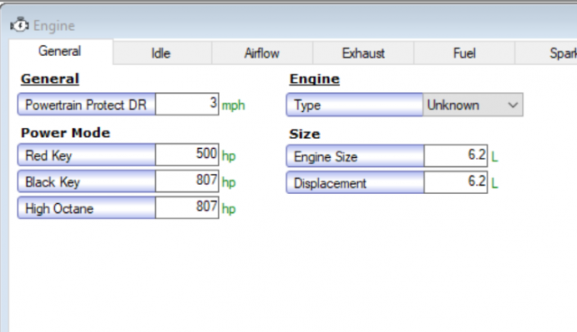

Got my bypass cable in today and read my stock tune...
What the heck is wrong with this picture??? Screenshot 2021-11-03 224526.png

Keys are backwards on power rating.
You be slow with that red key.
Screen says 807 HP with the red key... but why is it backwards in the tune?! The 2020 file I looked at was correct with red listed as 807 and black at 500. Weird...

Maybe you'll get lucky and it's 870 hp and not 807.

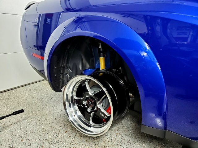

Test fitted my rear Welds tonight. There is only a finger width of space between the inside lip of the wheel and the sway bar, but guessing that should be ok. 20211111_182212~2[1035].jpg
