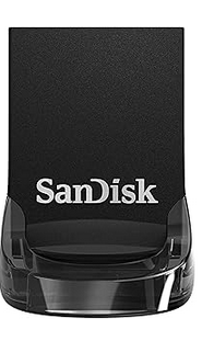

If you are concerned about the USB stick getting broken off buy a Sandisk Ultra Fit. Very small. 1759012127374.png

Appreciate all the assistance @Diboblo, thanks again. Never knew about that option in itunes @06SRT10NR . I will look into that USB device. @Catless Thanks you guys,
