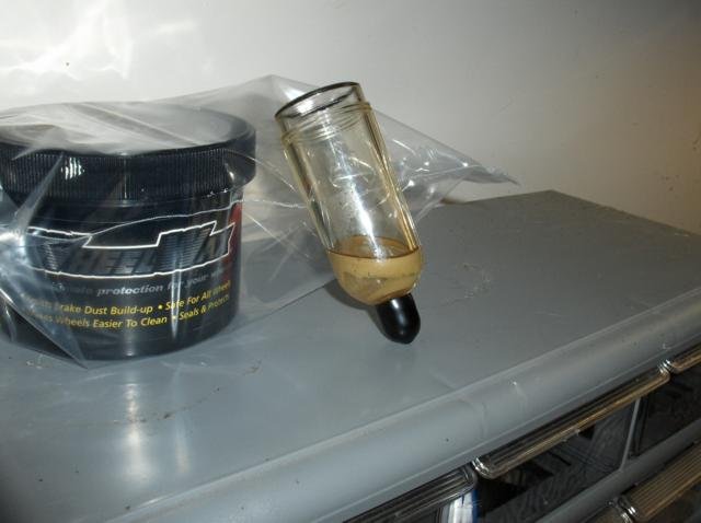

Had a home made one the SC GTO for years and never collected a drop other than right at first. And that initial "catch" was not oil, looked more like a fatty sludge.

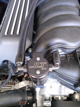

Mine does. Most folks use them on the p/s side and seem to get results with minimal result, if any, on the d/s. Here’s my JLT. 3ED21690-46D4-43A6-93B3-5576E69CB310.jpeg

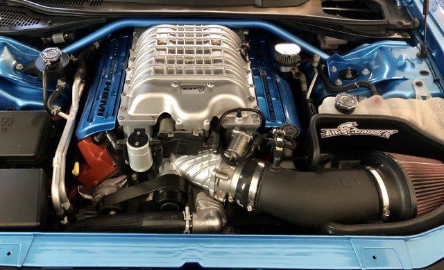

I've got the UPR block mounted on my RE. Dry at 1500+ mi. so far. My supercharged 6.1 usually has @1" in the cup at @3000/3500 mi.
