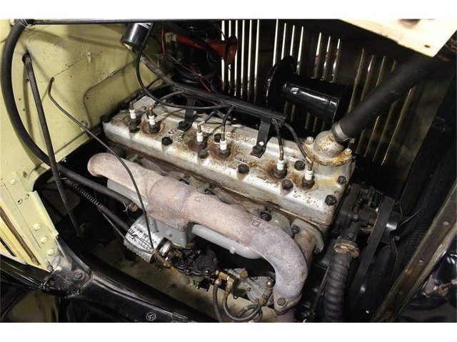

Guess one good thing about my Hellcat being a total garage queen is I will never have to deal with the spark plug change nightmare.
Performance aside, MOPAR used to make the plugs easy to change.
