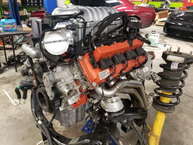

Small hiccup today. Texas speed sent the wrong mid pipe connection. Going to get a hold of them tomorrow and hopefully work to get those parts sent by a space shuttle. We are so close lol.

That's' better than Ole Bay on hell her, if not 18. Port and polished and lukin good. Thant is very nice. I will be there gain soon,, good and clean. I will be out of this home stead in 3 months and will be able to give birth to a new one I am looking at on Counting Cars Show, on now. One of my favorites. Moving back to whore #1 started back in 1996, 1st town home built, paid for in 2 years, stayed vacant for 6 years, rented out and now vacant. I am moving back with both cats after all this time. Wore show #1 after divorce, and only divorce, but gals to cme later in life. 3.5 garage with Catster only in #1 place. Tools and frig with JBL stereo and some pics is it. Keep the 1 I have ave and start on another one. I have to fid the people that ripped me off in the meeen time. Want advertise the back stages. Off to bed to sneep on it.

Good post. Thanks for the pics and sharing info.(y)
