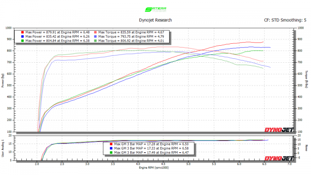

Thread Starter #93

75 horse difference with E85 is pretty crazy. I also would have expected more from E55. I was under the impression the difference in E50 and E85 wasn't all that much octane wise. Nice comparison!
Depends on how aggressive the timing is on the E85. Could be a very conservative tune on E55 also.
I'm sure the timing is fairly low on the e50, I agree with your impression and e50 is pretty close to 100 octane I believe. The "best" timing comes in though when the ethanol is better.

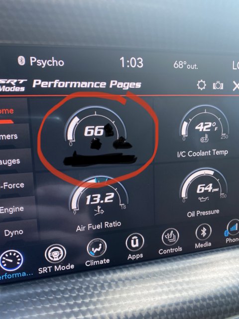

Another cool feature is onboard ethanol content....
What is that input normally supposed to show since its blacked out? Lol.
I figured he had to hijack something to make it work.
11,710
19,832
#99
Straight ethanol percentage by volume?

Thread Starter #100
IAT
