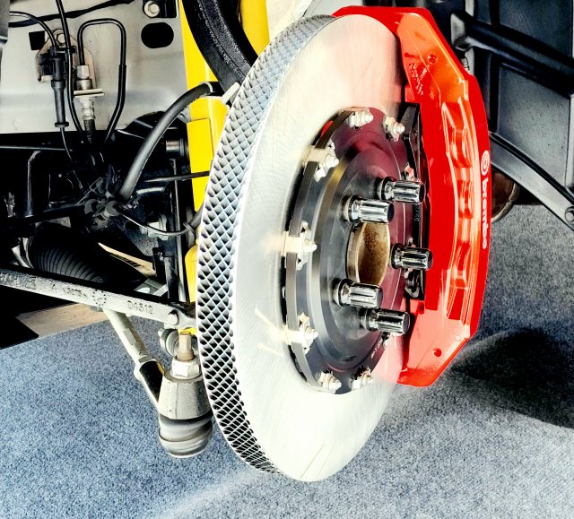

I hear there are some vaporware front brake rotors that can pull another 30lbs off of the front too...
Good luck finding a set...

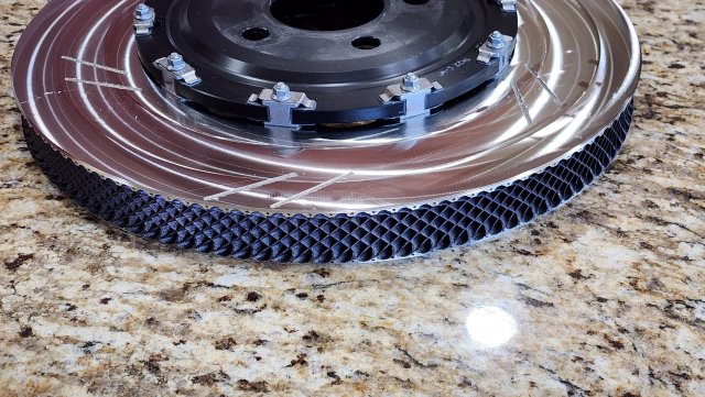

Gimme a rotor and a drill. How light do you want it?
  • Cost less than CF
  • More durable than CF
  • Same or less mass than CF (~16lbs w/ hat)
  • Less time to produce than CF
  • Dramatically less wear than CI, ideally lifetime durability under "normal" performance driving conditions
  • Thermal mass and coefficient sufficient for a 20min session at Brainerd (long course), also for 3 * 5min cycles of 200+mph to <30mph
  • Pass all relevant safety standards, legal and assumed.
  • And some other stuff too...
:unsure::whistle:

Nice!!! When are they going to be available?
1,714
14,341
23 Challenger Demon 170
I’m sure Bull would like it if was yesterday 😯
17,288
54,097
4,521
9,395
When hell freezes over... : (
That’s to help manage the temps, right? Not a horrible tradeoff.
