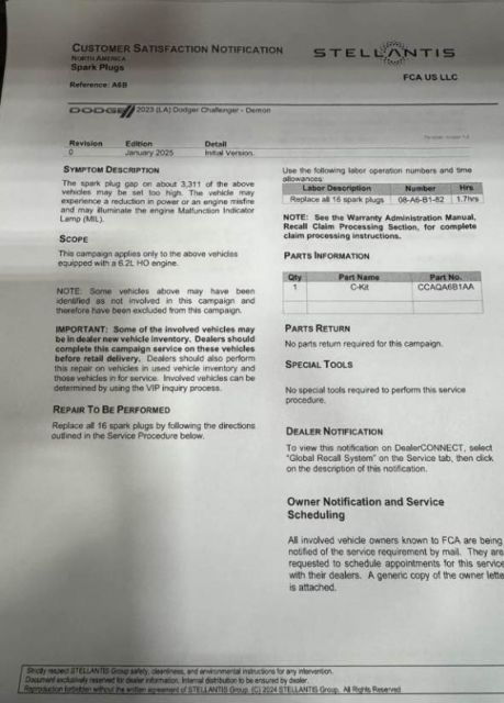

Interesting...looks like there's now a full campaign on replacing the plugs in all Demon 170s. Couldn't find anything on the replacement PN on Google, maybe because it's a kit. Mine's never had a problem, but I'll get this done now that it's a thing.
Shows a shop time of 1.7 hours so all these stories about plugs being hard to change must be folk lore :LOL:

I would buy a ticket to watch a dealer tech R&R all 16 plugs in 1.7 hours!
16,919
53,000
Yeah, either laugh at the real hours, or learn some impossible secret to doing it.

Well, the stated 1.7 hours is kinda good news. While I enjoy working on my own junk, I don't enjoy an 8 hour day leaning over an engine bay fighting with something as simple as spark plugs. Labor rate X 1.7hours makes it a no brainer to have the dealer do them if you have a good tech you trust.

1.7hrs is a joke that I will pay good money just to laugh at.

One of my good friends is the master tech at my local dealer.
59,751
208,134
Here is my guess, they don't unplug the coil packs. I have on a couple laid the coil pack aside and changed the plugs. My biggest issue is getting them unplugged. Spent too much time trying to unplug them first not seeing if there was enough wire to pull them out plugged in
My next plug change will happen with the engine out so may be awhile before I can test that theory

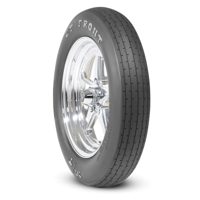

Time for new front runners and trying for something lighter weight than the M&H. This will be for track only unless I'm required to do some kind of 30 minute drive as part of a race event.
I was looking at the Hoosier Drag Front like this one: https://www.jegs.com/i/Hoosier/522/...PvLcDkIDdGeN0XR4FSKyPJ3lO-LVsomUy8gZDF0r9tgjY
Crew Chief Greg said to also look at the Mickey Thompson ET Front: https://www.jegs.com/i/Mickey-Thompson/672/30093/10002/-1
I know several run the Hoosier. Anyone have experience with the MT? The OCD in me would like the brands to match front to back, but I can get over it if the Hoosier is the play. NOTE this MT Front is not the Street Front radial, it is a 12lb bias ply front.
I could have picked up a new set of the m/t for $300. Decided i wanted the radials. Seemed most had the Hoosier billet specialties set up at demon race

The Street Front is a nice front runner, but I'm going for max weight reduction and they're 16lbs vs 11-12lbs for the bias Hoosier or MT from what I'm finding.
