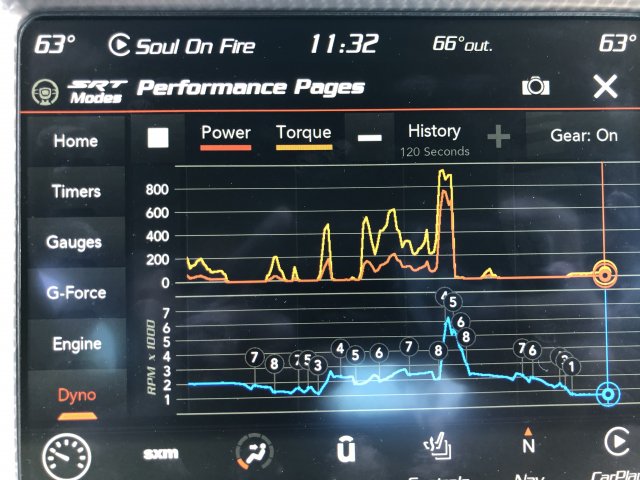

I like my 3:09's. They are fun, it is one hell of a hot rod. Last night mindful of attempting to replicate the dump in the 2-3 shift we have been talking about, I was watching my gauges to see what gear I was in. We did a U-Turn (all legal) on a four lane divided with a 65 mph limit, so the turn had some speed. As I came around a bit spirited it was in 3rd, AND the 345's were beginning to howl! Okay, I'll play. Wow, can you say torque? A slow depression on the pedal caused a bit more noise, but they were far from breaking all loose. At this point I DID NOT want a downshift. Sucker went thru 3rd then on and on quickly and bit down well, before merging real well ahead of all traffic coming.:p (Default modes- REWB 345/30 PS4S rears, all the anti-hop mods in the rear you can think of plus still has a hot tank from the track). It will allow some fun, even in default mode if you don't smash the throttle and try to make it look like a Ford.
