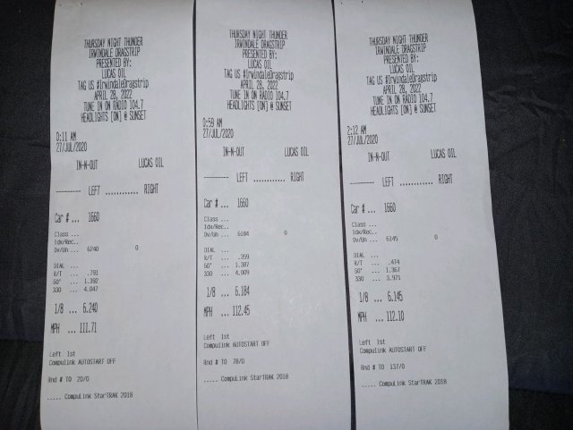

I had a pretty good outing at Irwindale Thursday. I was on the big tire that is taller and on a heavier rim, but still had the good fuel in the car. Ran a 6.24, then a 6.18 and finally a 6.14 as the night progressed. These were all cool down passes preserving the cooldown as much as possible. DA was 1450 going down to 550 feet. Not bad. I actually have new 28X10.5R17DBR's mounted on the Win Lites. Kind of regret not putting them on.....Maybe I could have improved on my 6.10 PB. I will kill it in the fall. I think the track is capable now...........
Also note, it is genuinely nice to be able to go balls out now without a word being said to me any more. So cool.

#988
1,154
2,204
House of power
Liking those 60' times..
