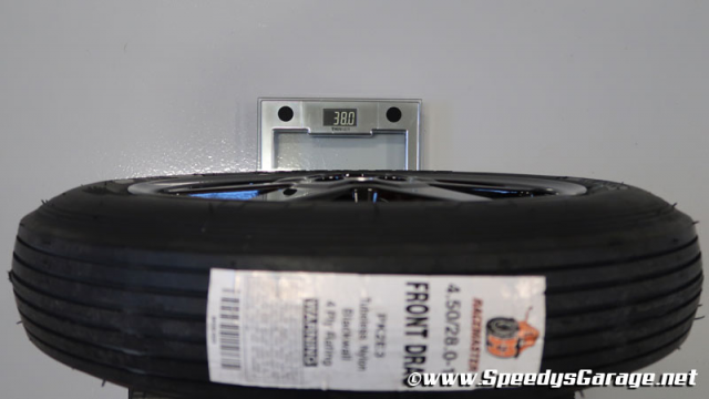

Now we're talking. Can't wait to see how it goes. How much does your race tire/wheel setup weigh? I've been looking for a reason to replace my cheap Race Star Dark Star 18x5 fronts with M&H 28x4.5 front runners but they only weigh like 38lbs each and so far I've not found anything better.

7,376
19,343
Thanks, I'll look in to those. I don't street drive on the drag pack setup either, but I kinda like the M&H tire for the weight of the Hellcat. I'll go back and check my notes on differences in wheel weights but looks like 5lbs from memory which is a lot actually.

Luckily my Weld 17x10 RTS or whatever they're called fit on the rear. They're light and a nice wheel (but pricey). It's all that was available back on 2010 for the Challenger. With a 28x10 Hoosier slick mounted the weight was 42lbs total. I think it was 7 or so pounds heavier with the MT ET Street R DR on there.
Edit, went back and got the video where I weighed everything. Weights start about 6 minutes in.
Hoosier 28x10 Slick 18lbs
MT ET Street R 305/45R20 30lbs by itself
Weld 17x10 RTS 20.5lbs
