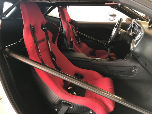

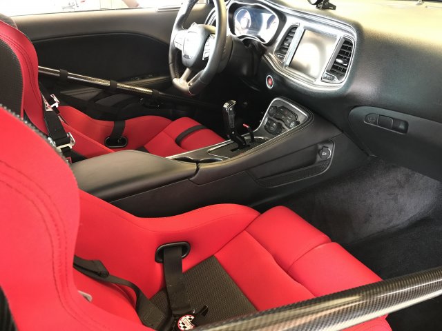

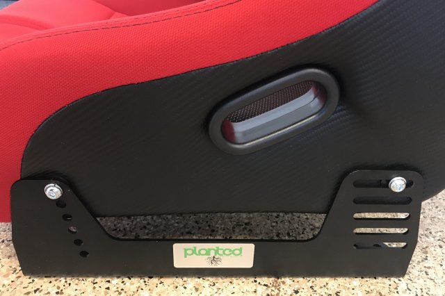

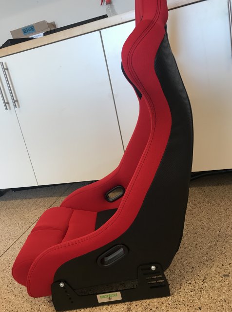

Hey Ron... I have the Braum race seats now and I locked them in place. Nobody but me drives the car so one position is ok. They are more difficult to get in and out of because of the high sides but that’s just the nature of a deep bucket race seat like this. I do not trust those light weight sliders to securely lock that seat down in the event of a violent crash, so I went with the fixed side mounts. The seat without mounting brackets is 22 lbs. I weighed them to confirm and they aren’t lying. I went with the heavier Planted steel side brackets but there are some real light (real pricey) aluminum versions out there. The brackets were 4 lbs if I remember right. So 26 lbs total. Thing is..... you have to place something under those brackets to reach the mounting points in our cars. I couldn’t find anything other than those heavy Challenger specific Planted bases that are a direct bolt in. So there was a extra 3 lbs to reach the attachment points and also raise the seat up to where I could see out 😂. So... end result was 29/30 lbs. 6FA2C0F2-ECC9-479D-A0F1-4766A7B4737B.jpeg 5411B26D-BE58-4360-9844-1DCEE33C8356.jpeg 2A8C70E6-9855-43DB-A69B-8856025C9AEF.jpeg 5AECE682-33B0-4165-99EE-055E5E8F0336.jpeg
