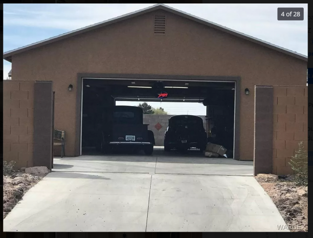

VIEW LOOKING IN BACK GARAGE FROM THE SIDE STREET 60' long W/8X16' doors

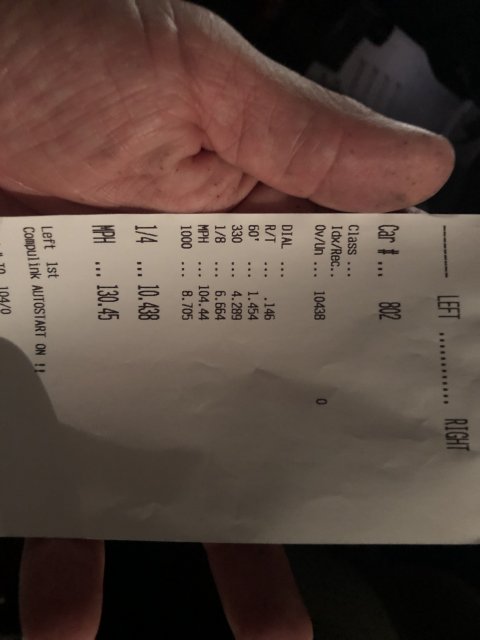

How are you guys getting the miles per hour out of your SS cars? I took mine down to Union Grove to do a little testing, and I barely broke 130 with my 29.5 DBR's and Hoosier skinnys on win lites. My best pass was a 10.43, with a 1.454 60', at 130.45 mph. All other passes that didn't spin were 10.5's-10.8's at 129 and change. I have sway bar off, rear seat delete, nothing in trunk, empty w/w res, 20 psi rear, 34 front, 100 octane. I don't have DA for the day. Temps went from 86 down to 74 for my best pass, with mid-level humidity. I tried from track to default settings, and let the auto shift itself. Track was sketchy, so I had to come out of the hole foot brake, off idle. I did check my on-board engine dyno, and it looks like it's pulling around 720-ish HP on the screen after a pass, though I don't know how accurate it is. Roughly 600 miles. Any words of advice?

DA can impact MPH quite a bit. Look up the weather on www.airdensityonline.com and see what that looks like.

Damn that’s disappointing, my best with my redeye was 10.002 @ 134.81 and a 1.434 60’ maybe I should have kept it !😖

I was going to look up the DA but I don't see a date on your slip. Like speedy said you can find it on line. If it was a humid day to go with your 80's temps your Da could have been 3000 feet.
Right now we are at 81 with 70% humidity and only 29.7 barometer so the DA is 2700 feet. Compared to 0 DA that is 3-4 tenths and about the same mph

That is actually a pretty good sixty foot for leaving from an idle. GLD should dead hook on any of the good nights. Sticky Thursday is my choice. If I was having any issues at all I would go to 18.5-19 psi or lower if I really wanted to stay and make more passes. Best 60 foots are going to be getting up on the converter a bunch. Probably .02 better.
Stage SHALLOW BUT SOLID. SRT Performance Spoiler might help. 2021 Drag Packs run it. I have my RH Mirror deleted.
Honestly I think Speedy is right. Probably just the DA more than anything else. GLD is something like 650 nominal feet. I think. My car only ran 133 in the heat at the Rock. It did 135 in the morning. I have done 137 in negative DA a couple times.
Once the car gets 500 passes it will pick up a tenth and a MPH. Also cooling down the motor/blower is worth a tenth and a mph.
If I want to set a personal best, I will fully warm up my motor if it is coming out of the trailer by driving it around 10+ minutes, then I will fan the blower down to ambient + 30 minutes. Then you want to go right up and stage. Daytime event, first pass in the morning when it is coldest.
If I make back to back passes (no shut off going right back around) my car runs quicker. Was able to do 3 runs in a row twice and the 3rd pass was the quickest both times

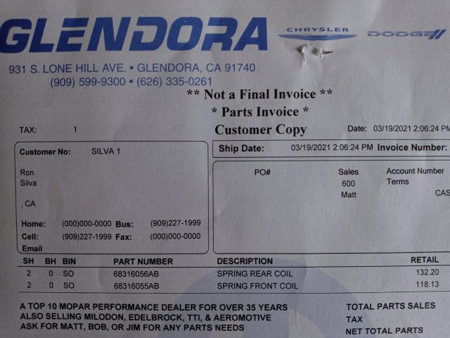

By chance do you (or anyone here) have a Demon VIN number (last nine digits'll do) so my parts guy can look up the coil springs? (or part numbers would be great if you have them). I want my parts guy to order me some for my Red Eye. I'm going to do a few things to my car in an effort to get better launches. My car only hooks about once each time I take her to the track. It's no fun running in the 11s (or maybe high 10s if I'm lucky). Getting to the point where i just pack up and go home... :(
I decided to put off changing the springs until after I get moved. I might be screwing myself. Because some of the Demon Specific Parts are drying up. The Struts we just got, the boxes looked 30 years old and they each came from a different warehouse and arrived at different times.
So, I decided to not pick up these Demon Springs yesterday at Glendora Dodge when I was there picking up a set of Sruts for my Friend. That means they have them "in Stock" available to sell to someone else. You can use any Demon Vin you want for lookup JH100465 and these are not restricted any more.

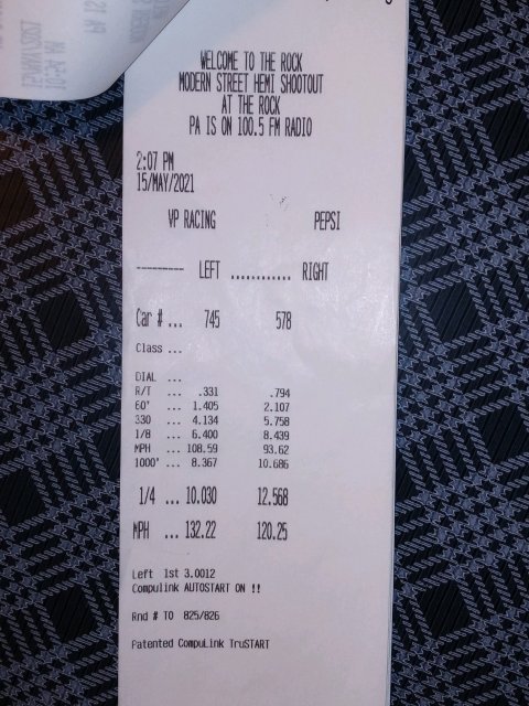

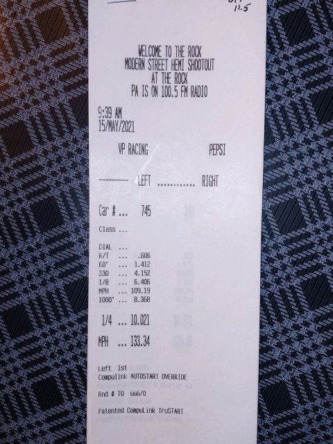

I went through my time slips from the Rock. I was mistaken. When I made my best passes I only ran 133. In the afternoon on Friday the car ran in the 10.20's and actually got down in the 129 mph range. So don't worry. When you get in some negative DA you will be totally normal on your MPH's.

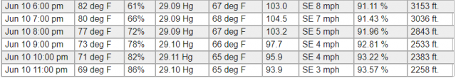

I want to thank everyone for the help. I looked up the DA, and it was pretty high when I started- 3200', and it was around 2500' on my last pass. I ran mostly 129's with the last pass at 130. It looks like I'll be able to pick up another 3.5 mph on a good day.

I ordered a set of demon springs from my local WI dealership, using the part numbers, and no questions were asked about VIN#'s
