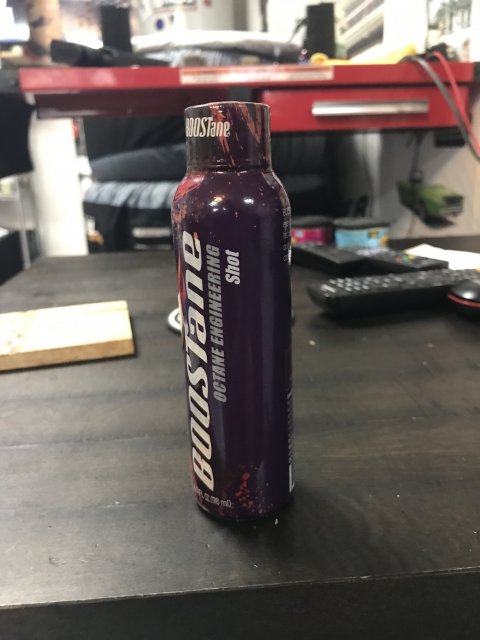

So you use about 8ozs. to a full tank ?... I use 2 > 3ozs. each time I fill back up after going to track, I just fill up to 3/4 tank. I adjust up to 97 or 98 octane from 93. On data logs it never shows knock.

They were not even worth taking photos of, honestly nothing remarkable. I use a 1/4 can of the professional per tank of 93. keeps the knock boogie man away. and every couple of months I run a tank of straight 93 with a can of seafoam through for shits and giggles.
I’ve run one of these 4oz bottles when I fill up from a 1/4 tank. Boostane calculator states this changes my 91 octane to 93 octane. I’ve been doing this on my 2015 since 2016 with no issues.
