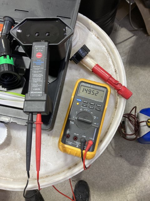

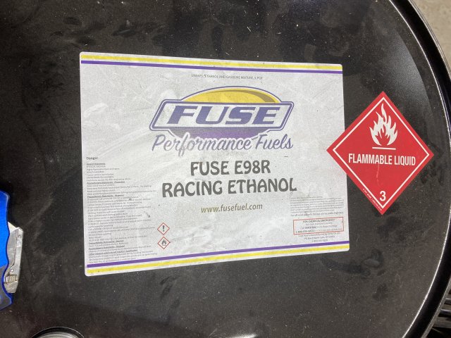

I picked up a 55 gallon drum of this today to get back up to 85%E :)
We’ll see how the car calculates it and if knock goes away or not. If Knock stays unchanged with higher octane fuel pretty safe to say it’s false knock?
Tester says it’s 99.5% alcohol

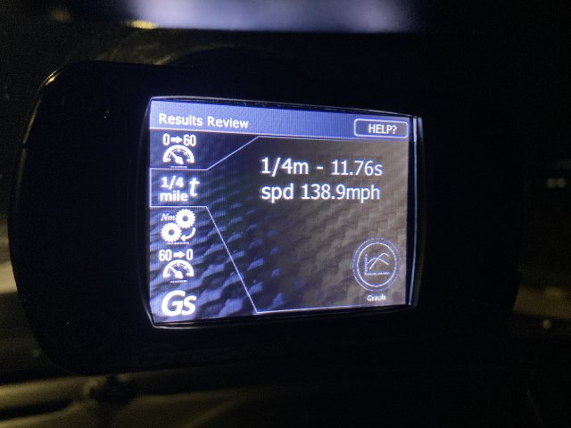

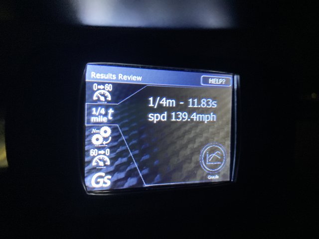

Whew some pucker factor testing complete. 48ish degrees 1800+ aircharge at wot. .811 commanded lambda and inj DC 78.5 at 6500 rpm with a reading of E80.
Tires breaking loose at 85mph is a bit more than I wanna contend with, but I had to know ya know.
11,025
It does get a bit "sketchy" . When I was testing in 60F temps I was breaking those stupid pirellis loose at 110mph . You can really feel the difference once you get up to 80% ethonal or more .
