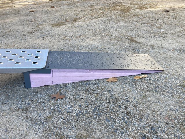

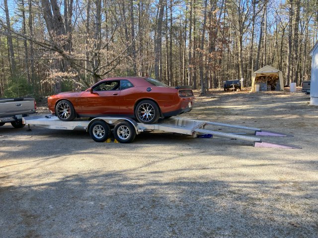

Spring FINALLY has arrived and I was able to set up the trailer. First was testing the custom race ramps I made, they work perfectly!

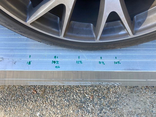

Next was figuring tongue weight, I set up a beam with pieces of steel angle to act as knife edges to put 1:3 on a bathroom scale. Then calculated tongue weight % based on car location and marked it. Now I have a reference so if anything funny happens at speed, I can adjust and know where from and where to.

I want to find the minimum, the 1/2t really sags a lot. I'm hoping it'll be ok with 10-12%, but I'll do what is necessary. Hey it's only a Ford, and it's under warranty! :ROFLMAO:

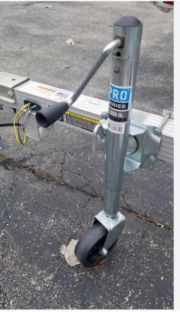

Balance without it sitting on the front jack. You can then tell how it's really balanced.
You don't want the ass end dragging.

Sorry, still confused. The jack was not involved in my measurements.

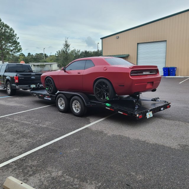

F150, 24ft. Look at position of car.

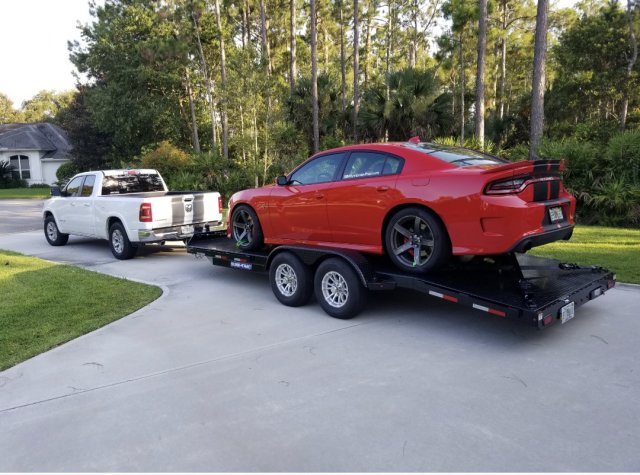

Same trailer. Different car and truck. Look where the rear wheels are.

That's also a heavier trailer, putting more weight on the tongue even when empty.
30,265
133,499
I agree.
Did he balance with the jack down or up?
If down he might need to move it back some since it's moved up on the axles.
