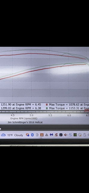

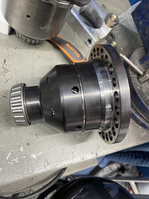

18F3E81D-903D-483C-8235-8C9923D2CC9B.jpeg 05944AB2-9848-4483-B022-F30B52307C11.jpeg
Wave trac vs stock

#67
Add the wave trac it’s a great rear end.
I’m going to see mine most likely
Sell??

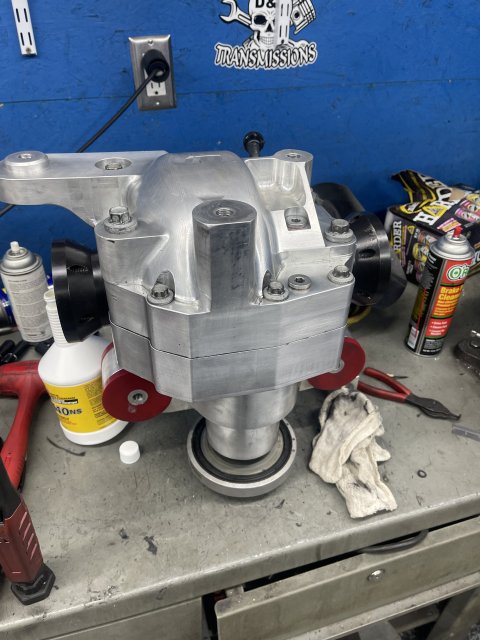

Which rear? The billet one? How much?
Yes with the wave track I would need 6500

Could it be possible the axles are not engaging enough in the wavetrac differential and putting too much stress on the end of the splined area ?? There are 1000's of outlaw axles out there are I haven't heard of any breaking like this.
Sent from my SM-S901W using Tapatalk
Nope all clipped in in wave track. I Don’t Know if Mike still has the pictures I sent him of the stubs twisted with the factory carrier. How many of the 1000’s are pulling tires for over 100 feet. I think I’m at the limit of them. But they say no
jon can say we still have a bunch of power we can add in the hit and still have not touched the nitrous
Lots of guys can carry this tires.

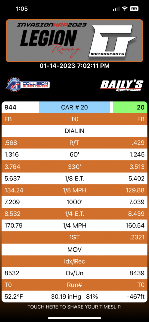

Lots can Humm I was in Texas and did not see lots
my shit is slow and heavy. And BTW the 60’ was measured off the back tire
6063EE4F-4D57-4E47-9277-E7E024C56EE1.png 66C82C66-A273-436E-AEF8-D22682D4B630.jpeg

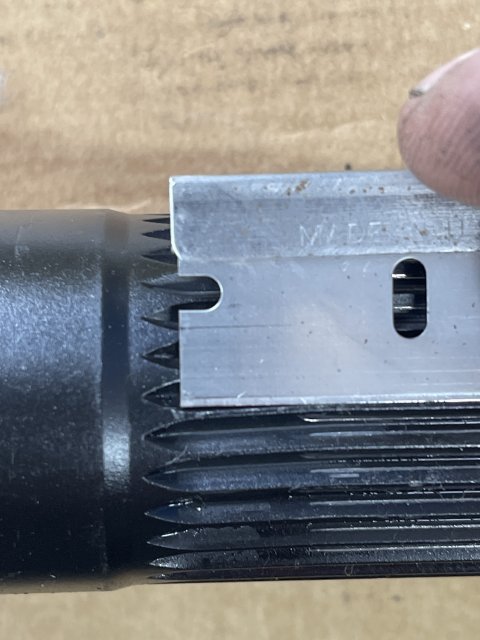

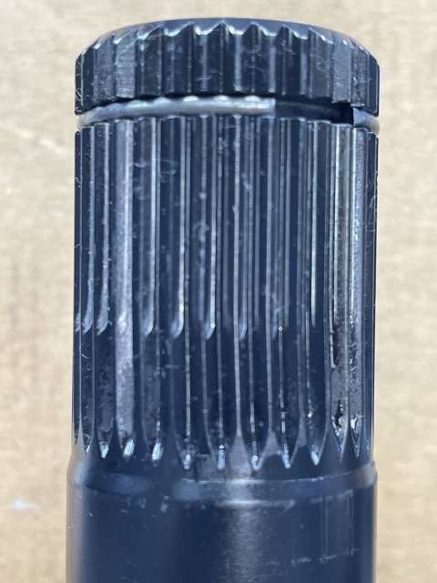

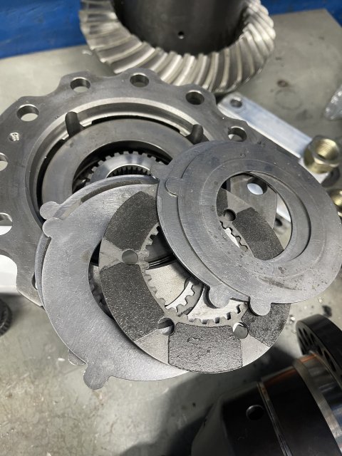

Here’s your first stubs that were twisting in a stock rear after only 3-4 passes. GForce replaced them for you for $300 each if I remember correctly?
They replaced mine completely with a new set because the stubs were undersize and wobbled in the Diff. The splines showed signs of wear and they didn’t even have 1000 miles on them. I think their having quality issues from their supplier, these things should not be twisting like they are.
I’m not impressed with them for the price. If I could get my money back I would and try the new DSS solid ones. I know a guy that was in DSS test group beating on them for over a year now running 5.6 in the 1/8 1.2 60 fts and they are holding up perfect so far.
255A4216-3F83-4951-93AA-5FD391E1F26E.jpeg BD8B6EED-1D3C-435D-9802-0462E172A277.jpeg
