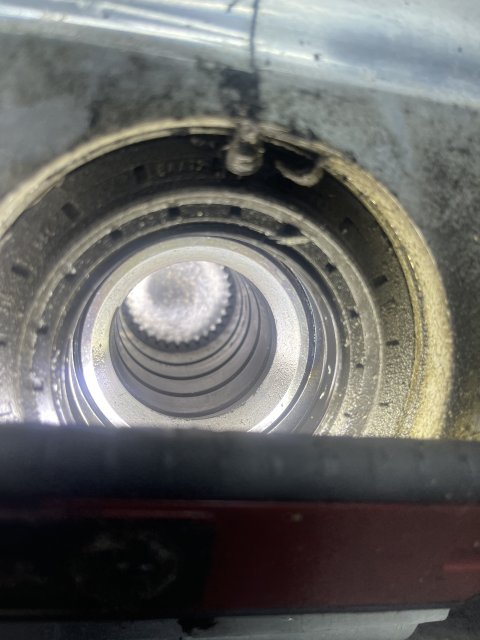

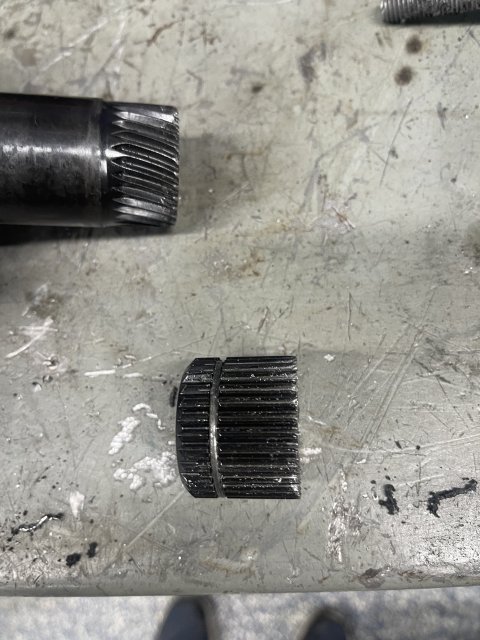

G force axles is this a problem????

Said the same to me. Looks like it is to me.

The interesting thing about that statement is that the cross-sectional area doesn't change between the area that twisted and what would be the "fully engaged" position.
(i.e., the shear stress doesn't decrease in a notable way, at least not until you get to a much closer area towards the tip)

If they're saying that the axles weren't fully engaged then are they making their axles just a little short?
They slide in and out due to up and down movement?
But the broken off shaft splines are twisted all the way back. Full engagement which =s a failure in the metal?

Sounds like they’re just making excuses. 🤷🏼‍♂️

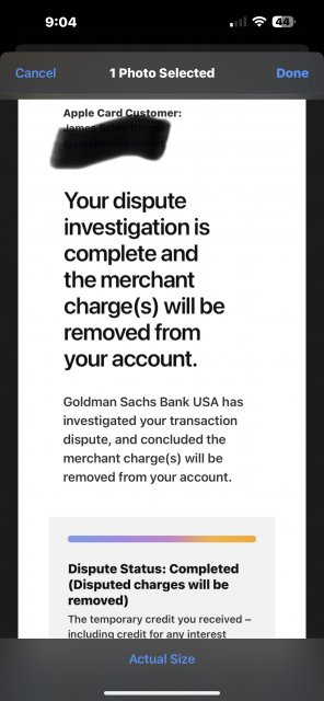

Won my dispute against G Force.

Nice!!!!

Excellent. What metal was that supposed to have been made out of?
Chinesey 🤣

No shit. I remember when we made metal in this country. And while there was some shit quality fly by night out there, there were always a majority of top flight outfits producing class A metals.
