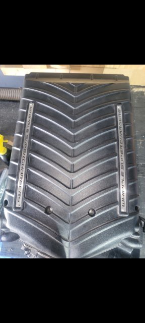

Got the Whipple. Will keep everyone posted on this build

Hopefully you clean up that blower, my OCD is triggered :ROFLMAO:
Is the ATI a stock size or 10% over drive? If over drive you need to clearance the front cover.
Yes the blower will be getting a bath before install lol
