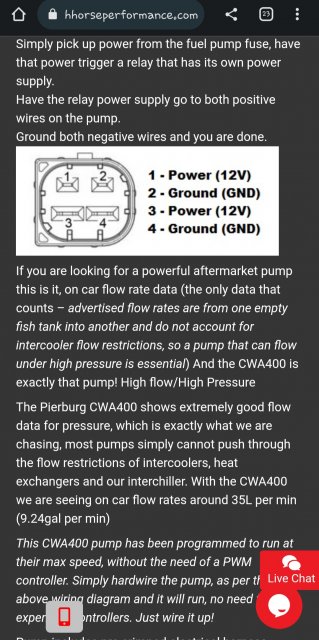

Been awhile since I updated this thread. Currently I'm on a nine day stretch on the road so I haven't had a chance to install the Whipple yet. I'll be installing it this upcoming Sunday. Some things have been brought to my attention. The BMR ice tank that I have doesn't work with the Whipple supercharger without modification. I have the stage 2 inner chiller. Does anyone happen to know what modifications need to be done to the BMR ice tank to make it work with the Whipple? I'll be going with a different ice tank soon but for now I'd like to make this work. I've also purchased a cwa400 pump along with head studs

A lot of people have issues with that tank. Pump doesn’t like the head pressure and makes changing plugs a nightmare.

A lot of people have issues with that tank. Pump doesn’t like the head pressure.
Switching pumps.
8,520
7,453
You can’t just switch them. It has to be ran inline
8,520
7,453
So you have to have pump on a switch (possibly tuner deactivate cels) or run pump on a switch in line with your stock pump to keep everything happy
8,520
7,453
Stock pump is canbus driven
Jon will handle the tuning bit
8,520
7,453
ok, just making sure you know it doesn’t just plug right in and there’s other things to consider

As with most things aftermarket, some things are left out and it’s not plug and play. That’s all. Bmr isn’t a good product. Should go with the bwoody tank.
