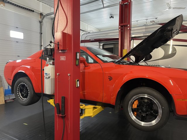

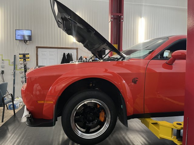

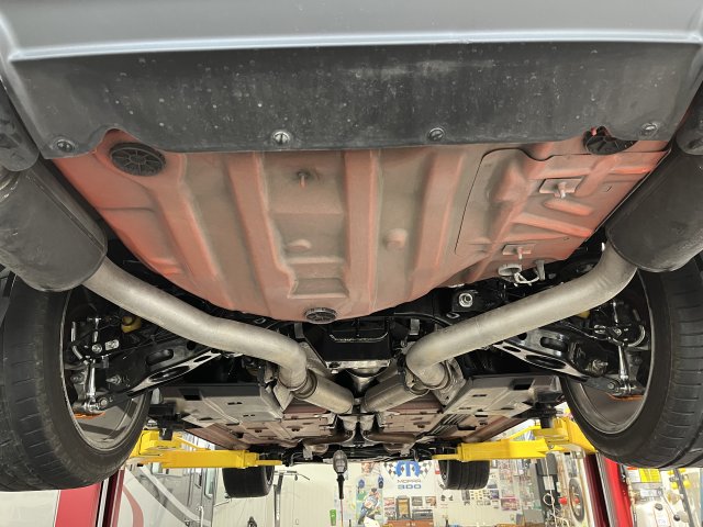

IMG_7697.jpeg IMG_7698.jpeg I have been taking my time and enjoying the “build”process as well as getting to know the car a little more intimately and am almost finished. I re-installed the exhaust and finished up everything at the rear of the car so the last thing I have to do, for now, is change the front springs out to the demon killer springs then I will take it in for an alignment. I noticed there isn’t a lot of adjustment in the front end for alignment so hopefully everything can be dialed in without too much issue. I see there are aftermarket cam bolt adjusters available which requires you to elongate 8 holes in the subframe to allow the cam bolts to work, either with a die grinder or a special tool from SPC. It would be nice if I didn’t have to go through that process. Does anyone here have any experience with their car in this regard ?
My hydraulic cart came in very handy again for re-installing the exhaust.

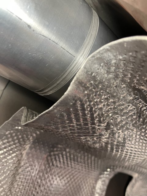

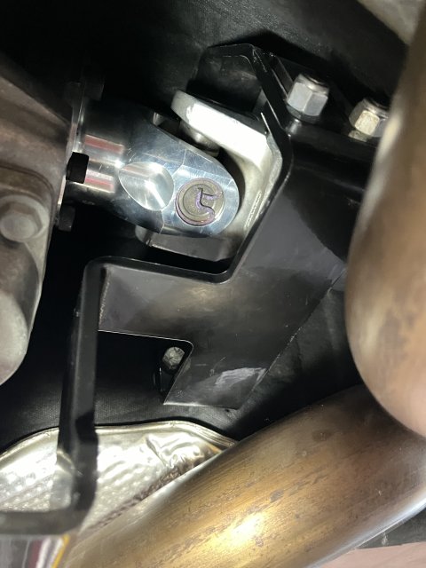

This whole setup was used when I got it and I noticed a small groove in the driveshaft when I got it all home. This was an area of contention with a few people early on in this post when I was being criticized for not following the “advice” I received about purchasing this setup. The groove is quite minor and the photos actually make it look worse than it is, but once I installed the driveshaft it became pretty obvious it was caused by rubbing on a heat shield. There was also a very small hole in the driveshaft boot which I repaired with a bit of “right stuff”. IMG_7677.jpeg IMG_7706.jpeg

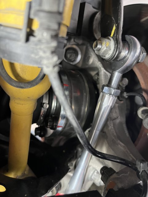

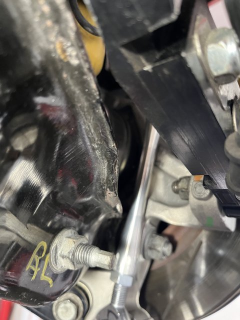

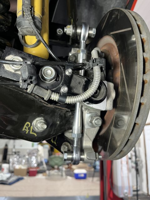

The new toelinks I purchased from HHP have lots of clearance now. IMG_7659.jpeg IMG_7661.jpeg IMG_7660.jpeg

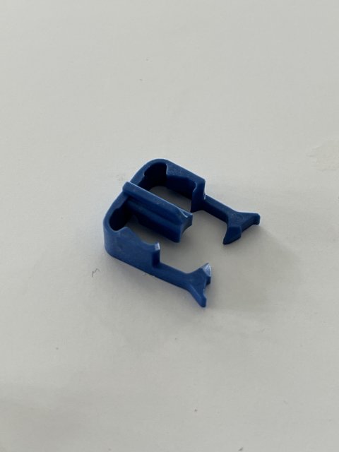

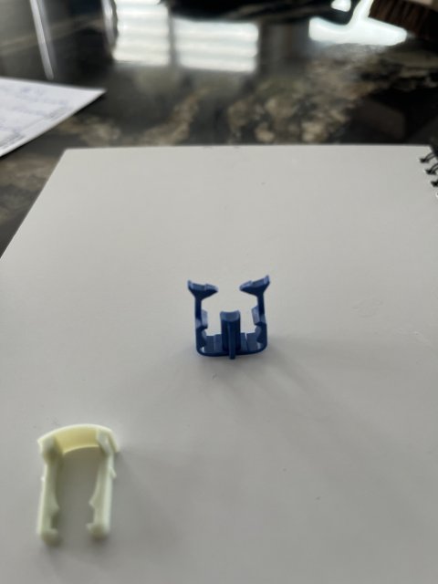

Well the fuel clip showed up from Amazon and it appears to be the correct one. $30.00 for a little bit of plastic but cheaper than the $150 Dodge wanted for the full line. IMG_7713.jpeg IMG_7716.jpeg

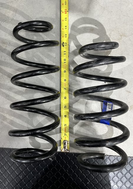

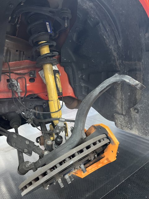

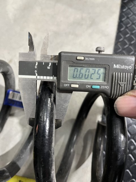

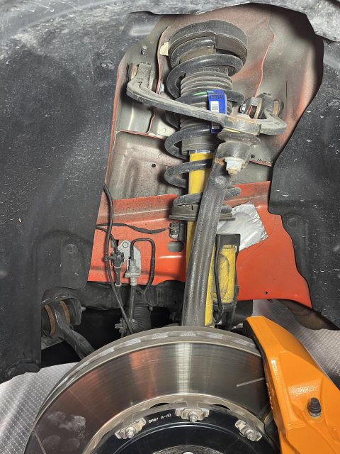

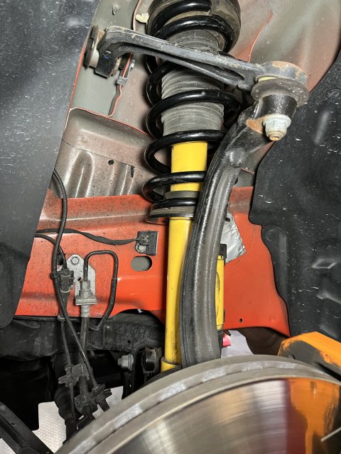

Changed out the front springs the other day to the “Demon Killer” springs I got with the used suspension package IMG_7730.jpeg IMG_7731.jpeg IMG_7733.jpeg i. They are actually from Dusterhoff Racing so maybe demon killer springs are different?
They are definitely taller than the stock Redeye springs and also a smaller diameter.

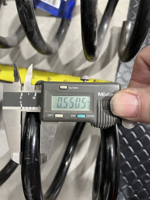

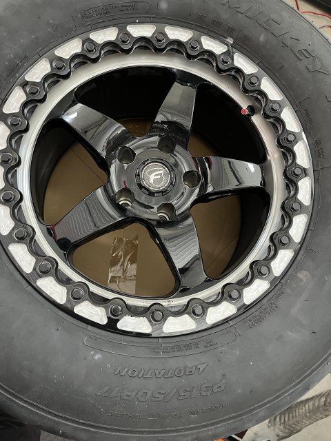

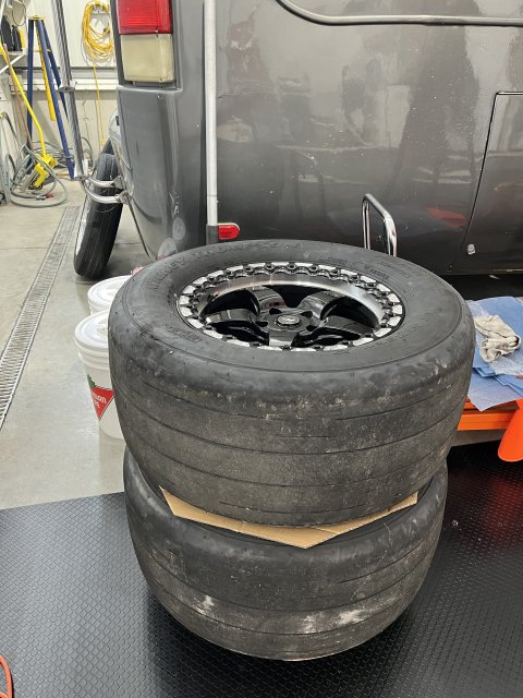

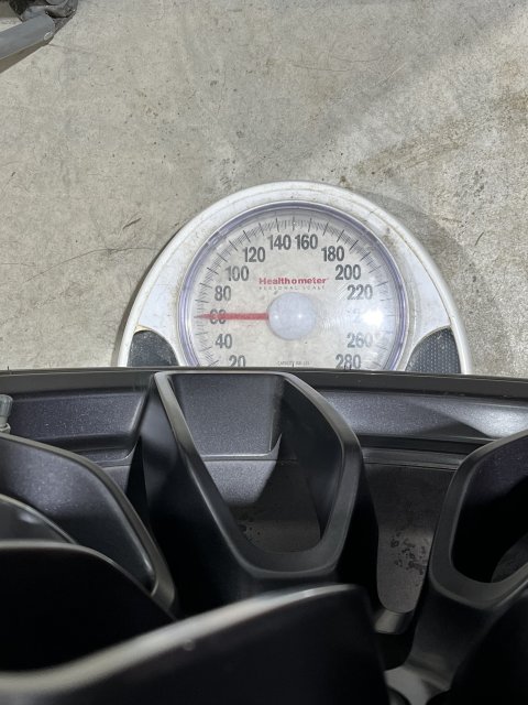

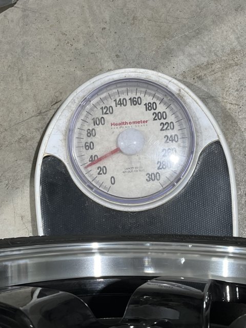

I also checked the weight of my front skinny compared to the stock wheel and rubber.

The ET street fronts are super light. I have a set almost brand new sitting here for sale (2022 date code). I switched to the sportsmans. I think my car is too heavy for the ET street fronts
