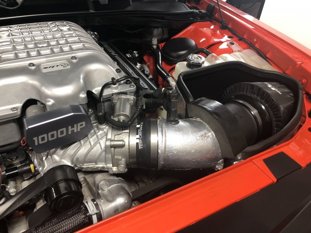

I wrapped my JLT box in heat reflective insulation and put a foam seal over the intake pipe
Any Idea if the extra foam seal and heat tape helped any? What did you use for the foam seal? I've got a JLT on the way, might have to borrow some of your ideas.
Foam is from McMaster Carr, it’s “skin” is 2” wide electrical tape. In my book every little bit helps lol

Speedy, can you please post any differences with how IATs react with the new JLT intake versus the stock one? I am curious to see what the rise and fall of the IATs are and if the IATs were lower cruising on the highway or higher cruising in traffic?
6,134
15,709
Murfreesboro
2016 Hellcat Go Man Go
Thread Starter #31
Man way too many variables to try to figure that out I think. I haven't had the stock intake on the car for 6 months or so. If I come across an old log of the stock intake I'll try to look at it.
What I can tell you is with the JLT the IATs were 35ish degrees over ambient cruising. So if it's 70 F out the IATs were 105.
