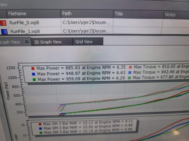

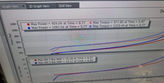

Some initial tuning from today. Pretty happy with the results so far. We had the charge pipe blow out on the higher HP pull, so it didn’t get to “peak”. Tuesday they will check for exhaust leaks that they may have heard on a pull and tweak anything needed. The “base boost” setting I was shooting for is all set. We’ll see what it does on a full pull with 19-20psi. They maybe try 1-2lbs after that to see.
So far very efficient 2B0F38BC-54F2-4098-8FEC-AAADDF9FCDC3.jpeg 5BAB8BFF-1C41-4A2A-8CFD-964513B93B51.jpeg
So far very efficient View attachment 52756 View attachment 52757

Most gas setups don’t pay a ton of attention to drive pressure until you get quite a bit higher in the boost, but it’s always an area that I’m interested in. Not enough credit is given to the drive-to-boost pressure, it’s critical to me.

@FFBOS - what are your gates set at? Can you make a pass at 11psi to show these guys what turbos make on stock boost?

They are going to check for any boost leaks in the exhaust Tuesday hopefully. We will make a couple more pulls to verify all is well. Want a clean pass on the 20psi setting. Then one or two more at 22-23psi probably to see if we can use that for an e90 only scenario. He has some drive tuning to do with it still before I get it back.
I don’t plan to “use” a boost setting around 10 psi, but I believe the base gates are at 7-8psi. I may have this available for when I need the car to be in “valet” mode.

Turbos on these cars are usually 30hp per psi I think? So just subtract 120 from 959 and its be close.

Gotta be close as you don't have the drive loss of the blower anymore...
I know Satera was claiming upwards of 100-150hp from just gutting the blower on a compound setup and using it for the IC core only...sounds about right.

Yea, looks to be 30 per, we shall see. Hopefully it sees the dyno tomorrow again and we can button it all up aside from some daily driver street tuning. I want to see the clean pass at 19-20psi.
