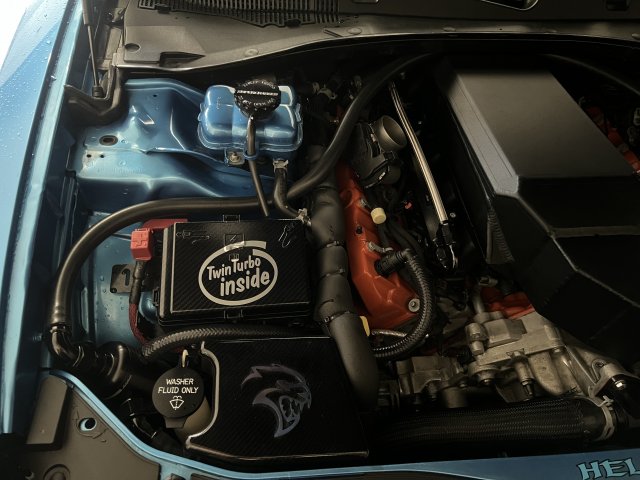

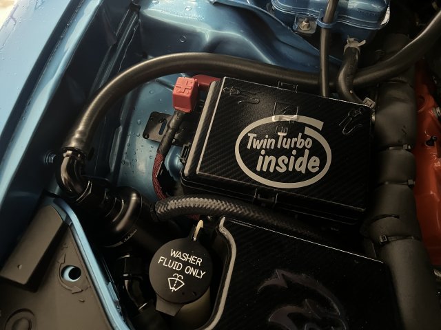

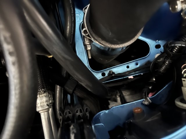

I used to vent this Mighty Mouse catch can under the hood. Needless to say it was getting overwhelming as far as the in cabin fumes go. I found that this company also offers an option for the top vs the filter. This is doable for anyone running their cans as long as you vent it with a big enough line. This 12an they “rate” at 1200hp. I guess we’ll see what happens under WOT. If the dipstick doesn’t go airborne, we are good to go lol.
