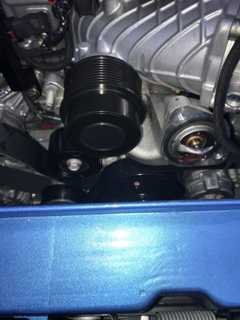

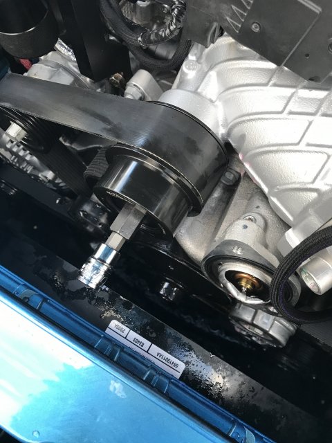

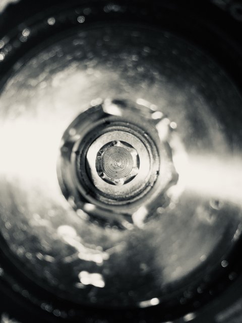

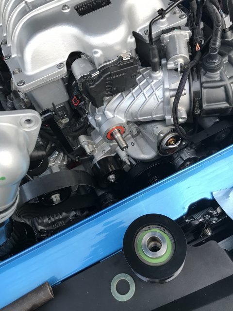

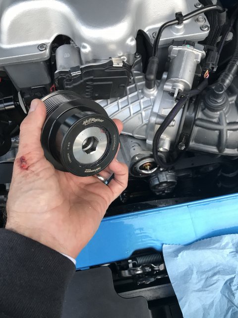

Here's an update on the Hellraiser pulley install on my RE. Did the install last week.

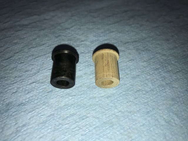

I got snout back from Jokerz (Very fast turnaround, got it back fast) with the ceramic bearings installed. He believed my "marble sound" was the bushings and could see nothing wrong with the snout or Hellraiser pulley. He said he could send just bushings and give snout back buuut just in case it wasn't, I told'm to do the whole race rebuild(no porting). With that I got the ceramic bearings but I also opted for a custom shaft that has a hex machined into the front so you don't have to remove the blower to swap out a pulley. You have to drill a hole through the 17MM hex tool that removes the pulley so you can get a 10MM allen wrench through it and keep the rotors from spinning. Thought that was slick and hope it works. You still have to drill a hole through the tool and move the radiator hose out of way to do removal but it's better than removing the whole blower! Just hope the 10MM allen has enough surface area to hold the shaft without stripping and that you can get a clean hole through the 17MM hex tool.

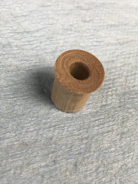

The bushings are custom made for him. They seem to be a cloth fused with a phenolic resin and machined to size. They are softer than the factory bushings and cushion the sound. The factory set is supposed to go 100K, he says his may go 50K? But in his words "hey it's not perfect but it should quiet the noise if that's what you want".
Result: It still makes the noise but more muted and seems to come and go. Before it was just "marbles" at idle when hot period. The noise goes away when off idle whether stock bushings or custom. Still bothers me, I may do more.

That second pic reminds me of an ACE bandage. Hope it works out for you.
When I said cloth, it's still solid. It's like a matt they rolled in epoxy and hardened then machined. It's just not that hard brittle type plastic. You can feel it when you tap them into the coupler, they have some give and are tighter than factory. He's only sold like 25-30 sets so far. I bought a set of replacement bushings form JB performance that are hard plastic like factory to give me an option. I may switch back.

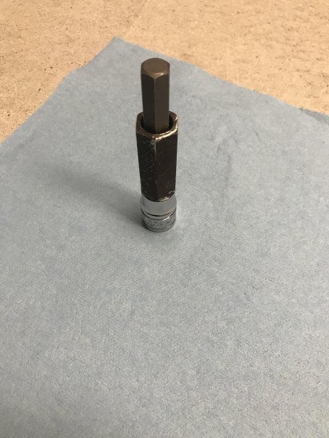

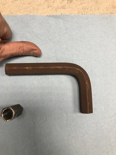

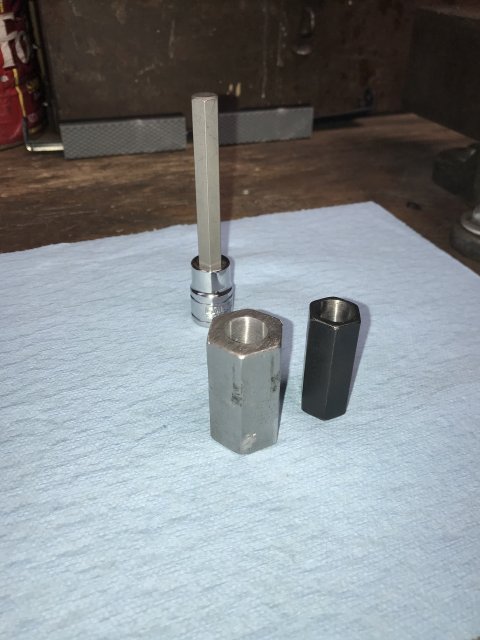

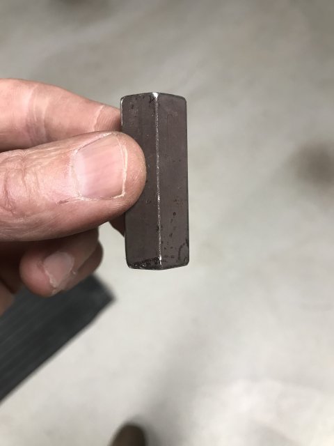

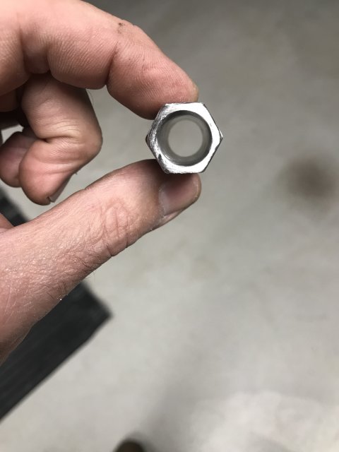

Latest..... Home made Hellraiser install/uninstall tool.

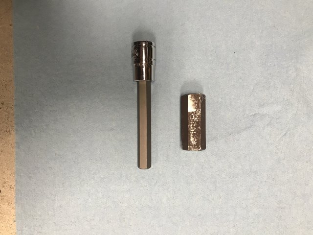

Well today I made the the hollow hex tool that is required for a Hellraiser pulley install/ un-install without removing blower or snout. WHAT A BITCH!!!!!!. OK, I bought the the custom shaft from Jokerz that is machined for a 10MM allen to hold rotors stationary while removing pulley, BUT he doesn't sell the hollow 17MM hex the 10MM allen has to go through to remove the pulley. NOW I KNOW WHY. I bought the pulley alone without the kit, so I don't know what Hellraiser's/Litens hex installation tool is made of but when I had to make my own Hex tool I bought an old USA made tool steel 17MM allen wrench and cut off a hunk to make my own. This shit is hard. I mean one step below a socket hard. I could not dent this thing. Hack saw barely scratched it. Had to cut it with a 4" steel cutoff wheel. Tried to mark center with a punch...not a mark. I burned 4 drill bits and 3 or 4 carbide head porting tools to do this PLUS it took like 5 or 6 hrs to do it. Ok, let me make this clear...the hole you see in the pics was NOT drilled. The bits would not cut. I did this BY EYE AND BY HAND TOTALLY FREESTYLE with a head porting tool over six hrs. There's not much meat on the bone on the perimeter of the tool so I'm glad it's hardened steel. If this thing works when I try it, I won't sell even for $1000 after the work put in. Patting myself on the back but I'm pretty proud of this little handmade do-hickey.

American steel for the f-ing win! Great work man. Especially free hand.

I sell you what's left of the original 17MM allen. You could make your own. Nice winter project. It'll take you till spring to get through so start now. :LOL:.

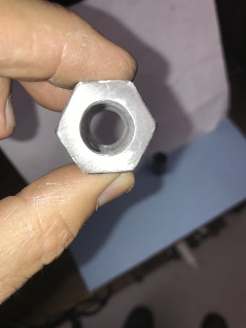

Wow , the 17mm hex that comes with hellraiser pulley drills out easily fyi, good work though!
2,695
Thread Starter #56

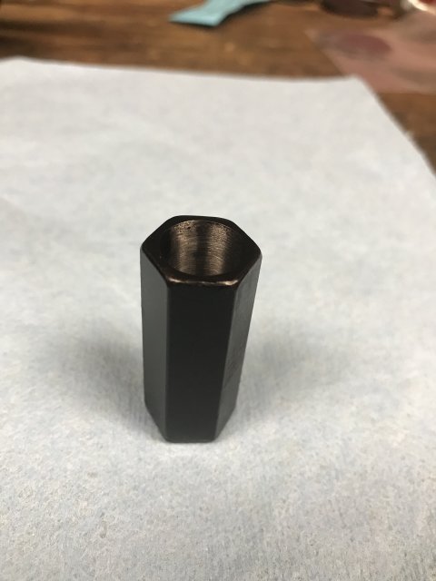

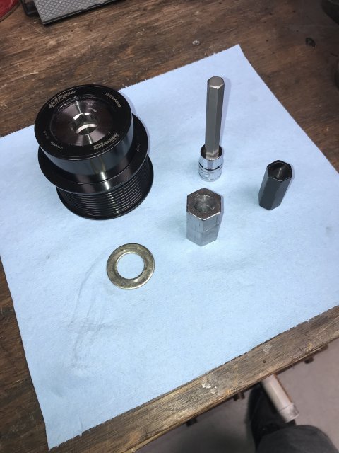

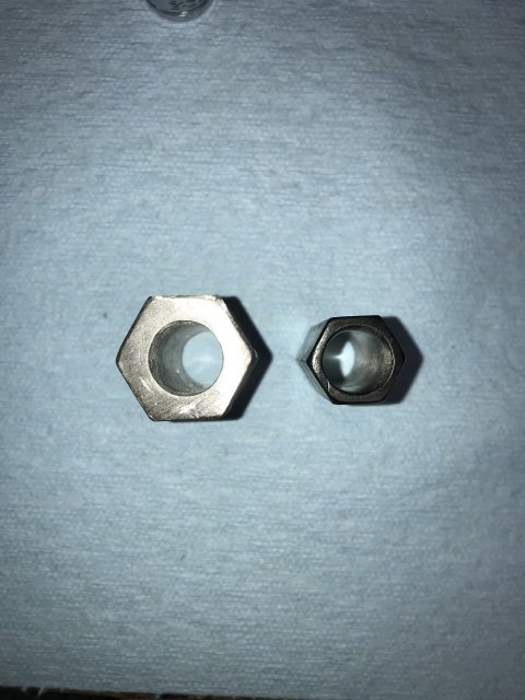

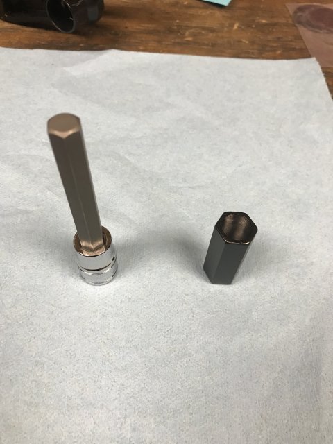

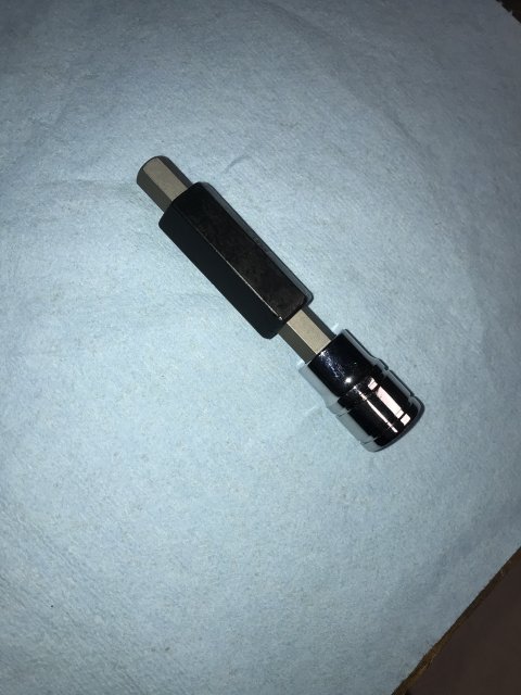

I'm going to drill out the bigger Metco hex tool so I'll have a setup to go quickly between the stock and any other Hellraiser size pulley down the road when I get it tuned. Hopefully the Metco drills as easily as the Litens hex like your saying.
Have you actually used the quick change setup with the 10MM allen to hold the shaft? I'd like to know how it works. That 10MM scares me a little. It just doesn't look like it would hold the shaft with much authority.
3,828
9,071
#57
I'm going to drill out the bigger Metco hex tool so I'll have a setup to go quickly between the stock and any other Hellraiser size pulley down the road when I get it tuned. Hopefully the Metco drills as easily as the Litens hex like your saying.Have you actually used the quick change setup with the 10MM allen to hold the shaft? I'd like to know how it works. That 10MM scares me a little. It just doesn't look like it would hold the shaft with much authority.
The hardened one you drilled out will!! Put a box end wrench on it, put a hex key in the shaft with a tight fitting cheater pipe on it, and give the tip of the box end a quick wack with a 5 lb dead blow, that should pop the pulley loose. Put a big tripled up towel under the tip of the box end to keep it from marring any thing below it.

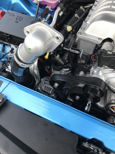

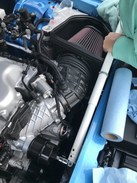

OK, latest in the saga.
Today I made the removal hex for the stock pulley. The hex tool from Metco was a hell of alot easier to drill and port than the tool steel allen key I made for the Hellraiser pulley. Now here's the fantabulous , wonderful, over the top, joy O joy, ...happy dance. IT WORKED!!!! BUT let me say, it still wasn't easy. Making the hollow hex tools sucked both times and that Hellraiser didn't want to come off. I had to cut the end off the box wrench so I could slip a pipe on for leverage, and had my wife hold the 10mm allen with a 3 foot pipe on it. It was tight getting it all in there (in fact you have to slip the tool/tools together as a unit then put it in the pulley because if you put the hex tool in the pulley then try and maneuver the 10mm allen in place you can't swing it). But once all was said and done it's way easier than removing the blower and other surrounding components to swap out the pulley! If I had to do it again, I could probably do it in twenty minutes. Here's the BIG NEWS. Once I put the stock pulley back on......NO MORE NOISE (No more marbles in the snout).

So the HR pulley failed somehow?
No. This is my thinking.
