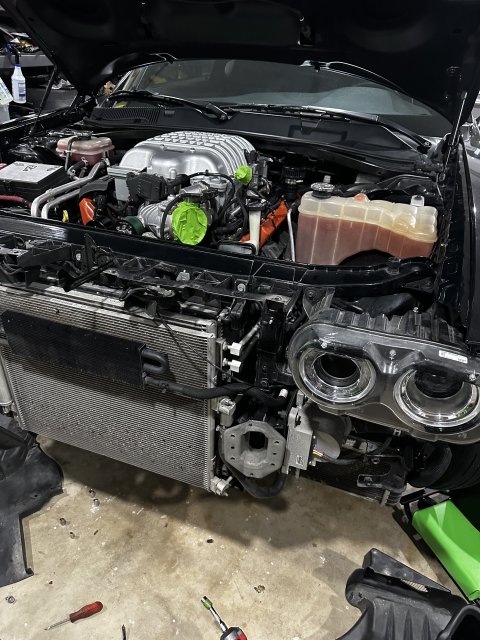

Getting ready. Found a bolt from my crash beam I thought I lost 4 years ago in the heat exchanger air duct lol. You can see the worm clamps where I’ve had this all apart before

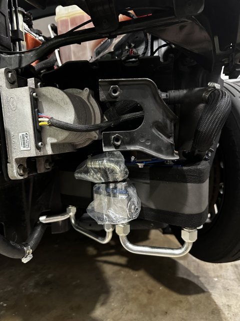

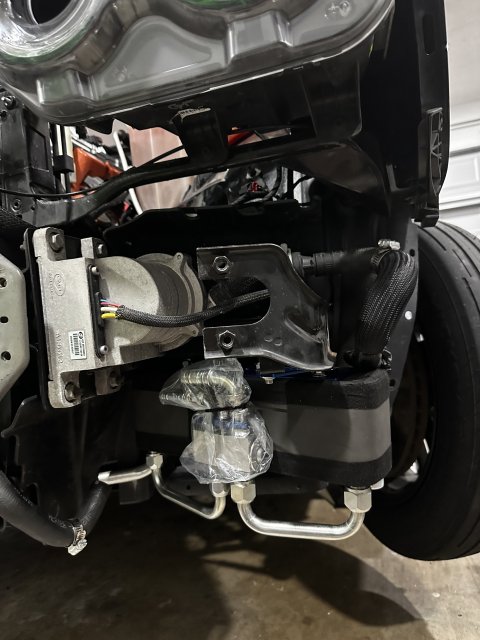

Thread Starter #17
Getting mocked up. If you already drilled out the spot welds on your crash beam (like I did) I recommend pulling it completely, makes life a lot easier

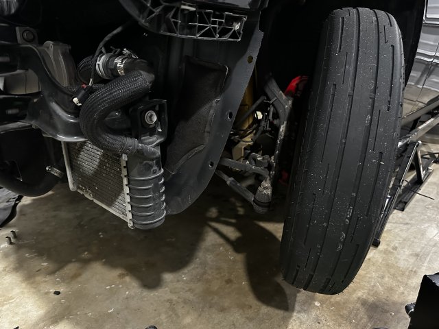

Thread Starter #20
Just got back from Lowe’s with a nice hose cutter and insulation. Hose still isn’t here yet 😑
