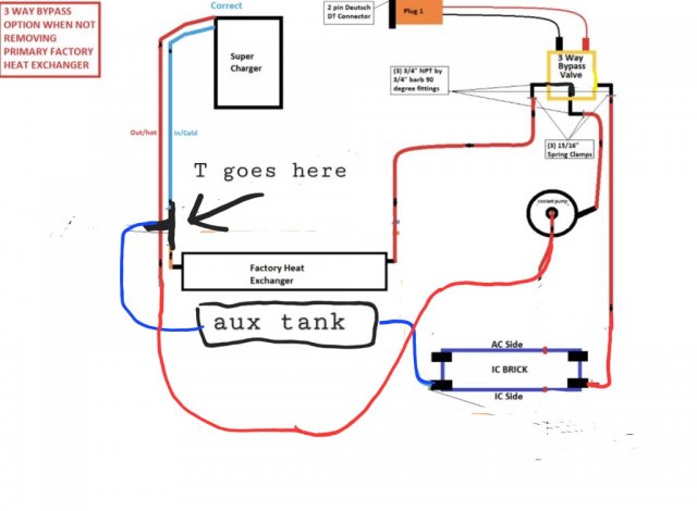

I have done seen 2 different ways to plumb the 3 way valve....which is the best way or is there a best? Or is it just a matter of choice? I will be using the aux. tank and my car is a street and track car.

There's more than 2 ways to do it...
You have to ask yourself:
* what behavior do you want if/when something fails
* what behavior do you want to be the default (jump in, forget to throw any switches, and just drive)
* do you care how much plumbing you have to do? (some ways require running another line across)

Thats where I find my problem....shouldn't only one way? My car is street and track car but I want the chiller to do what it's intended to do.So what your saying is if something fails such as what? As far as the plumbing goes I'm willing to do what ever I need to for the best results with all things considered.

I’m in a hot climate, so I have my air on all the time, thus the chiller works all the time and the heat exhanger is bypassed by default. If it’s freezing cold out (never), I flip the switch to turn on the 3 way valve which flows the coolant through the heat exhanger and the chiller with the air off

I'm like you I live just outside of Savannah,Ga. so were about the same.The way you have yours is the same way I want mine to be....only difference is I'm running the aux. tank

So it your thought's would this be the best way to plumb it up? 3wayvalve.jpeg 3wayvalve.jpeg

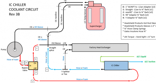

I'm in the same state of mind as rookerrobert.
I'm going to plumb my setup the same way. It will either run through the oe exchanger OR the chiller. I don't think I'll do the refrigerant valve on the chiller side. Yet. My thought process is if I do need max a/c, I can put the 3-way to run only the oe exchanger. Since no coolant will be flowing through the chiller, it will reach superheat (or supercooling?) quickly, and start closing off the chiller txv, leaving more cooling power for cabin a/c. Chiller won't freeze over, so no worries of the chiller slugging the compressor? This is my sketch, adapted for trackhawk and no aux tank.
