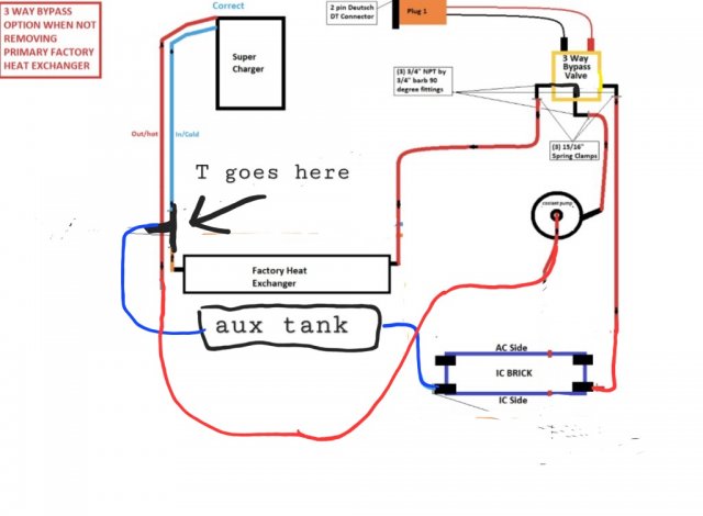

I read you guys post every night....I'm wanting to buy the chiller and get the aux. tank with the crash bumper.And I dont want to feel dumb but I'm 68 and this new stuff get the confused. I guess what I'm trying to say do I need to get the 3 way valve? And if I dont get the 3way valve I wont need to put a switch in the car....or am I reading to much into this. I plan on keeping the stock heat exchanger.
rookerrobert
#8615
321
215
Ridgeland
SC
2016 hellcat A8 and 2016 M6
The drag valve and the 3 way valve are to different things correct? or is the switch inside the car for the darg valve?
catdad
#869
104
149
Lake City
2019 Charger Hellcat
Yes 2 different things. Drag valve shuts off cabin ac. 3 way valve bypasses the heat exc. I use the 3 way vale in my system. When its hot in summer time it was taking a while to cool the cabin. I have 2 drag valves on mine, one works with the 3 way valve. If I use the heat exc it will shut off the chiller system. Once my cabin is cold I turn on the chiller and everything works great. Also in the winter time I rarely use the chiller. I over complicated my system but I like my ac ice cold.

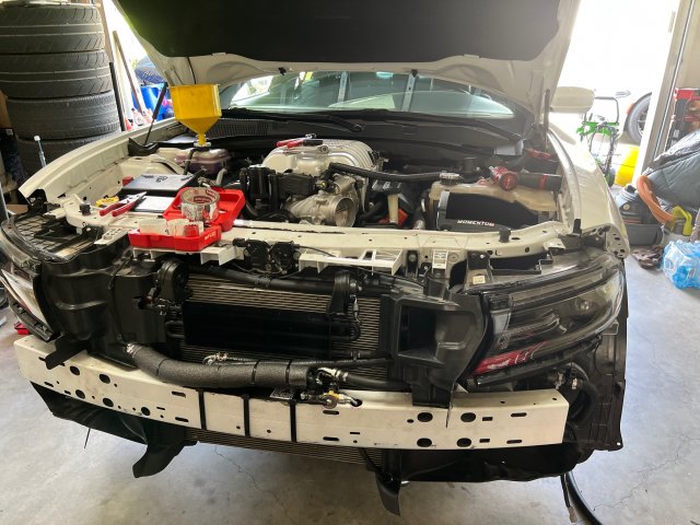

catdad
#869
104
149
Lake City
Just a few pics of my install 67425420720__A1A53747-C9F4-42CB-AE18-6E00EB1D1B36.jpg IMG_1212.jpg

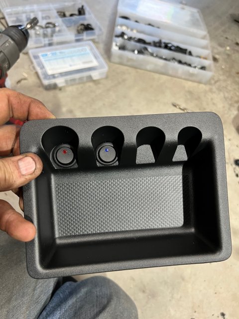

thats what I like not having to cut anything....the only thing I dont like is having to put a switch in my car I like to keep mine unchanged. But I'm still going with the ic chiller.I'll just hide the switch the best I can.
5,471
4,513
Thread Starter #260
You can put them inside your center console
