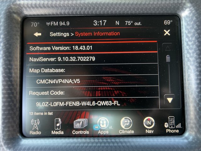

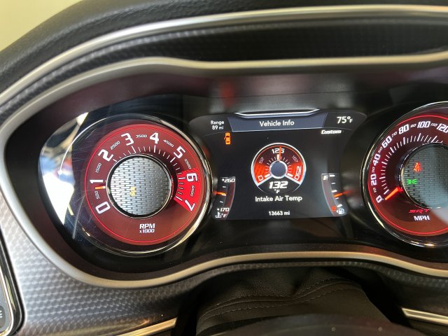

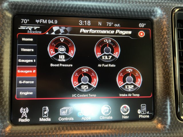

Assuming there is some "function" to load software from a USB or SD card and you can simply select the file to be loaded, theoretically you could load any version you want.
FWIW, this is the software version that I loaded with a USB drive some time ago. The IAT matches. ('16 M6)

4,533
18,237
#55
6,999
18,078
Thread Starter #56
That all looks correct to me?
4,813
25,380
#57
My 2015 auto has 18.45.01.
I believe that's the most current one when I checked the Uconnect update site, today. Are your IATs in agreement?
