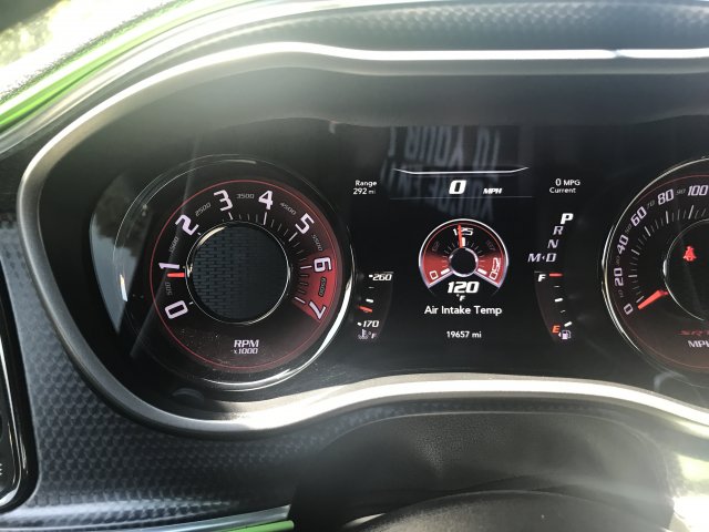

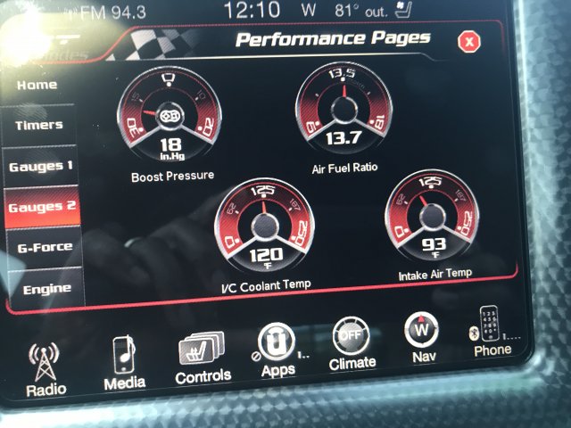

I believe that's the most current one when I checked the Uconnect update site, today. Are your IATs in agreement?
Never looked but now I will.
16,878
52,875
#62
4,842
25,687
#63
Here you go. Note the name of each is different. Back in 2015 we were told there were different sensors that fed these displays.
BF7F2D31-16FE-4756-BE0E-F2B232C419AB.jpeg 307401FA-C4B0-4297-A596-C34AA3EAAAEB.jpeg
7,305
19,147
Thread Starter #64
Yep, and now on my new unit the IC Coolant temp doesn't show at all. They've got some kinda issue there with the later OS.
