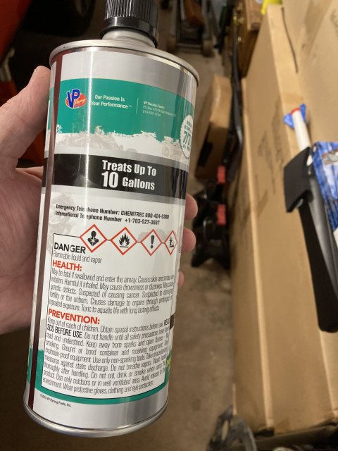

Has anyone used the VP fuel cleaner after/octanium?
VP Octanium Unleaded: VP Racing Octane Booster | VP Racing Fuels, Inc
Will Octanium® Unleaded leave orange deposits on my spark plugs? Will I have to change my plugs sooner?
In a word, maybe. Octanium Unleaded may cause orange deposits on spark plugs as a result of its high concentration of MMT. As a result, we would recommend adding VP Fuel Cleaner with RP21, which is formulated to clean and restore engine components. In addition, you can also blend Octanium Unleaded with gasoline at specific ratios, which will add even more protection for emission control devices (see chart above).

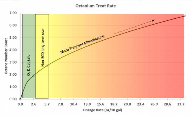

I have not, but more than that, that chart is only showing 7.0 for an increase in octane, whereas people are using it at 10.0 points or more.
Yet it's pretty much "red" at 5.0 points and implying very frequent maintenance??
Telling to me.

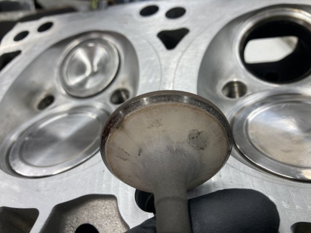

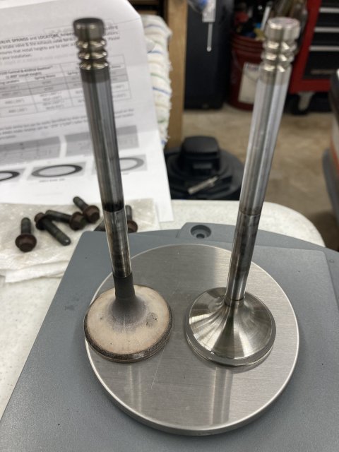

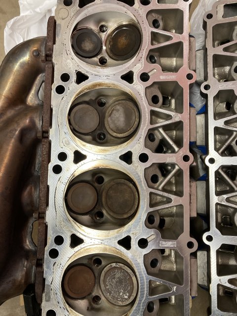

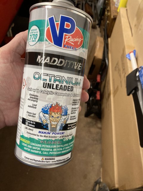

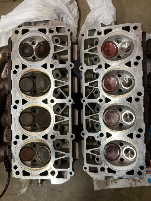

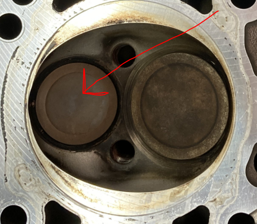

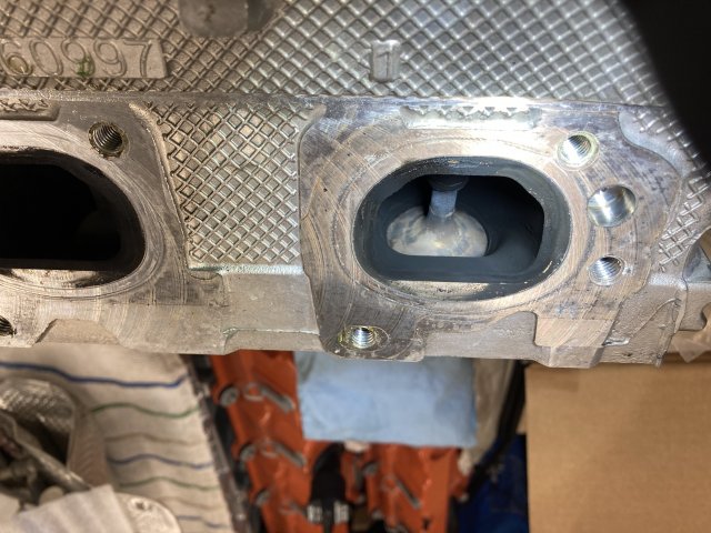

Never used the cleaner but after using it for 9-10,000 miles 1 qt of Octanium Unleaded per 15 gallons of fuel (1 can every fill up) I tried every industrial cleaner I could get my hands on including MEK, Triclorethyne, lacquer thinner, gasoline, kerosene, oven cleaner directly soaking it for days on the valves of my heads turned upside down nothing short of a dremel and sanding disks took it off the exhaust valves. Worse was the seats both on the valve and in the head only way to clean them up was lapping compound. My days of MMT use are over!! Took a few evening to clean things up. I at one time swore by the stuff, now won’t touch it or recommend it’s use, in fact I discourage it now. 889E2313-EE4B-479F-9095-B2AC72BED5EE.jpeg D35DA093-D060-4E8A-A9F5-F2CC00C2ABDC.jpeg 06A7620E-7B24-47D6-A5E3-BA8C8D8CB9AF.jpeg C9C85033-F5D5-4B46-BB3B-66F42BB4E4F8.jpeg 6249281C-A1D3-4804-BCC6-03D8342A2DE4.jpeg 0042355E-7987-40BF-A7CD-357D332CED9C.jpeg 28671941-4F71-4BB6-81A8-BC9845EB3F8D.jpeg 0C012EA5-F5F2-4F4D-B919-423FB414189A.jpeg 6EB86C17-1A0E-4036-9681-7057D47BE6A7.jpeg 2303A2E0-4AFF-4375-BC0F-9C52E2E8B538.jpeg

I'm not sure on the difference between Octanium unleaded & Boostane mix rates for a specific octane level but according to that chart with 2.5 oz. will only gain 2 points of octane. A lot has to be used to get from 93 > 98 octane or higher.
With Boostane Professional 2.5 oz. in 8 gallons will gain 5 points & get you from 93 > 98 octane.
98 octane is what I shoot for.

Never used the cleaner but after using it for 9-10,000 miles 1 qt of Octanium Unleaded per 15 gallons of fuel (1 can every fill up) I tried every industrial cleaner I could get my hands on including MEK, Triclorethyne, lacquer thinner, gasoline, kerosene, oven cleaner directly soaking it for days on the valves of my heads turned upside down nothing short of a dremel and sanding disks took it off the exhaust valves. Worse was the seats both on the valve and in the head only way to clean them up was lapping compound. My days of MMT use are over!! Took a few evening to clean things up. I at one time swore by the stuff, now won’t touch it or recommend it’s use, in fact I discourage it now. View attachment 63767 View attachment 63768 View attachment 63769 View attachment 63770 View attachment 63771 View attachment 63772 View attachment 63773 View attachment 63774 View attachment 63775 View attachment 63776
I don't see 1/4" buildup of residue that's been stated by some.

You better look closer then.
That is well over 1/4" if you use what's known as the "internet measuring system". LOL

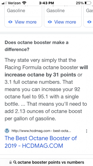

And there my friends is the magic trick. Points and numbers are 2 different things!!! It take 10 points to make 1 octane number, so you better get adding more boostane if you want 98 octane. MMT is MMT, it takes just as much no matter the brand to increase octane the same amount!!

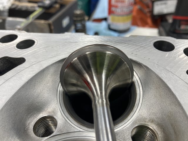

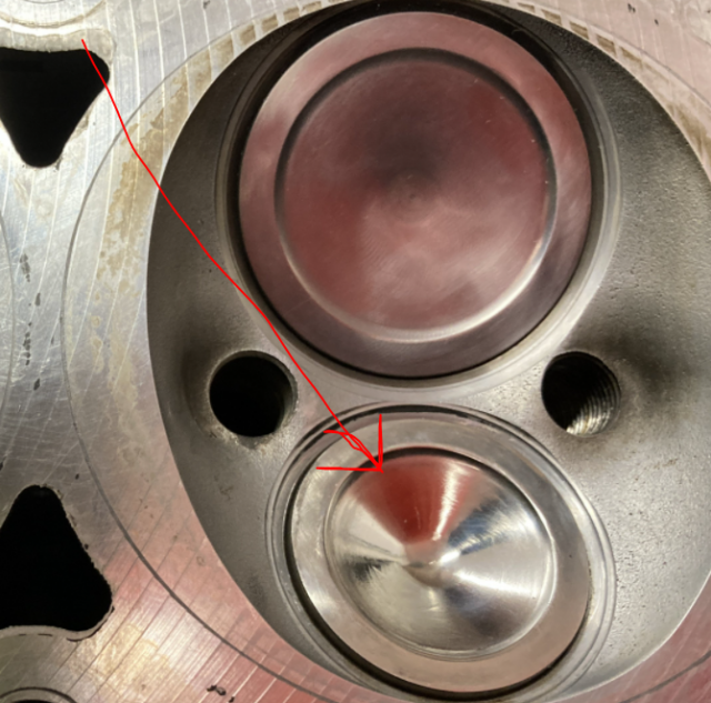

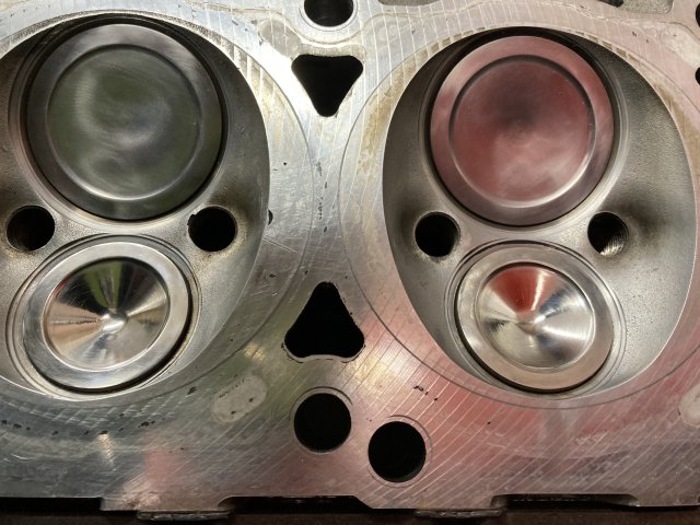

Look at the indented tulip on the exhaust valve, see how deep the clean ones are? Now look at the dirty ones, some are almost flat to the top, the tulip is gone. That tulip shape increases surface space so valve can get cooled some by the incoming air and fuel charge. Take away the surface area take away the cooling area, worse yet add a layer of insulation (MMT build up) over the top of it and it starts to get real hot. What happens to a hot valve? Valve stem clearance disappears and you start scoring valve guides or worse have a valve stick open and the piston will sure help close it for you!!

How deep are the tulips in the exhaust valves Mike? I KNOW you measured them? At least 1/4 inch or are my eyes playing tricks :)
Almost 3/8” deep
