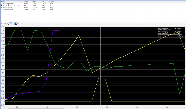

You saw my first post in this thread correct? That was my car BONE STOCK. Definitely not fine. This thread is not about performance.

Those drag strip logs were in good air, like 50 or 60°F. I was getting a lot of knock as you saw. Race gas helped.
I have other logs, I can post screen shots if interested where I tested on the street the following summer. Same thing. On 93 I was getting a TON of STKR on 93. Like 3-4 deg throughout the RPM range. Started mixing in 109 unleaded race fuel and re-testing and the higher the octane went the lower the STKR was. On 93 I actually had LTKR logged which is bad.

Bingo. I can tell you FOR SURE when tuning a car if we ever saw 3deg of STKR much less 5deg we'd have been pulling timing immediately and not letting that happen again. I'm not sure what Dodge was doing or what "91" octane fuel they were tuning these cars on but no way it's a good thing. Maybe they did some kind of torture test and figured it wouldn't break until the warranty was up and banked on most owners not going to the track or something, who knows.
I also tested 500hp mode as a comparison. No knock to speak of. Switch it back to 700HP mode and knock in the logs. It was just tuned too aggressive from the factory at least for the 93 octane I have access to.

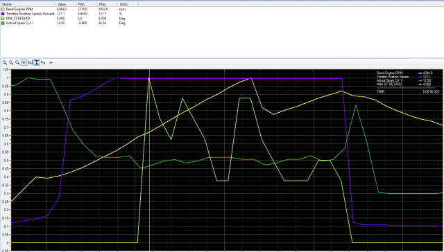

I went and found these logs from some summer street testing back in the day. This was June in TN so figure 90 degrees and humid.
First log is on Shell 93. Knock all through the WOT pull in 3rd gear.
Added unleaded race fuel to bring the octane to about 100 and re-tested. Almost zero knock.
