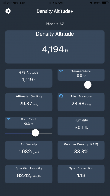

As much as I would like to spill the beans, I’ll have to let James share his news. I’ll just say this.... when you get up and check the weather at 5:30 am and it’s 91 degrees...... you know it’s less than perfect for doing this. But it’s Phoenix in July. Dyno room was 110*, the DA was 4200’ and Maggie was singing like a fat lady. 😂.

Alright let’s start out with the weather. It was awful lol. Now the temp says 99 outside but in the shop on the dyno was 110 degrees. I swear that’s my lucky number. Last year same time with stock blower it was 110 degrees.🙄😂😬
Now on to the good stuff.
We hit 1075rwhp and 1010 torque at 6200rpm. After the 3rd big boy pull Tim Barth says not enough spark going on in side. It’s like trying to make power and some one is blowing out our spark.
Max psi was at 21.4 and IAT’s in the first 2 pulls hit 109 and the last 2 pulls hit 129.
So after all Bigjonracing dual idler pulley set up worked out and did the job. Zero belt slippage and mission accomplished. Now I will be back at SRT AutoWorks when it cools down to check out the spark plugs and some tuning adjustments.
Next dyno just for fun will hit 1125 and 1050 torque give or take and then hopefully some dam seat time at the track. In California everything is shut down. It’s just to dam hot anyways. 122 degrees last Sunday 🥵🥵🥵.
