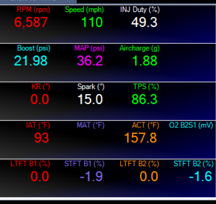

O and I know I said fuel trims were great with these 1650s here is a wot pull I did yesterday. They are at 1%
O and as you can see I have plenty of duty cycle overhead.

Wow - 22 psi!

22psi, i saw this once and then blew up my bypass valve 🥲
Turn the Volts up on the bov so it doesn’t move 😂

Only 15 deg of timing? Wus lol jk
My alignment is on Monday. Then we will add more to the street tune. Even with the 305s on the back at 15 degrees it is still hard to make go straight. I left some pretty nice lines out by my local dealership. I took one of the sales guys for a ride.
he said well that’s the fastest car I’ve ever been in 😂
Also IAT advance pulled 3 degrees the tune is set in the 19 range. Intake manifold temps were around 170. I need to figure out a way to stay cooler.
