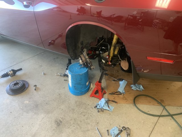

Third time doing axles this month. @vortecd came over to help. It helps having a second hand.
Put new axle seals in. Hopefully it stops the leak. About 2 hours to do both sides.
Didn't the car have the stock axles when you got it? Were they bad or did you upgrade because you had the GForce ones?
Upgraded because I had the geforce axles already on hand. The car actually had wheel hop issues. At least one axle was broke in the car. I didn't want to play that game.
So 3 weeks ago I put these axles in. The night before a race I saw some diff fluid under the car after driving it. So I pulled everything apart and checked it out that night. It looked fine. So I went with it but still noticed some fluid would come out when moving the axle under the car so I did the seals.
