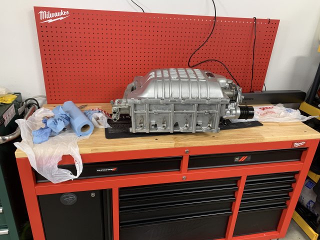

Starting to be winter project time. Step 1 remove blower from car! Thanks for the hand @vortecd

Nice work bench

I need more Matts I marked the wood up a little 😢
7,490
19,688
Meh, that's what it's for, mine's marked up too. My older work bench had a steel top. Can't hardly find that for new ones.

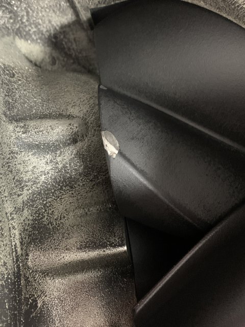

Biggest mark I found. Not terrible

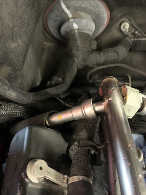

glad to see dodge fixed the fuel rails and the connection. That thing isn’t just going to fall off if not popped on just right.

That mark on the rotors can be fixed right up with a Sharpie :ROFLMAO:
61,169
213,756
no one will see it so doesn't matter but yeah sharpie if you have ocd:unsure:

What you think happened?
Nothing I’m overally concerned about. As hard as the blower has been spun in impressed
It's sort of amazing that the coating, which to my understanding is basically just sprayed on, doesn't just sling off at the rpm's the rotors see.
Some people are spinning it much harder than I do. But yes I was pretty happy/surprised with the results. I’m adding an ice box over winter which should also help
