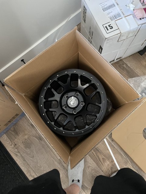

New wheels for car trailer so they match the car:geek:
hahah that man putting bead lock on the trailer!! shewwiee that's how you know its a race car!!

They are just some small 15s with a beauty ring that bolts on for looks. :)

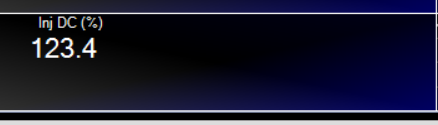

I am just now looking at the log from the 156mph run. Well it could have been faster but at 137mph this happened.o_O Pass 1 when the car cut out fuel pressure dropped but not much. So one of two things happened. I am having a battery issue and the bap couldnt give me the 22v or the pumps died. Lckily car never went leaner than .92
shouldn’t the bypass valve have opened around 90% Inj DC to save the day?
Have seen on a few cars doesn’t always work
Oem broke that functionality for model years 2018-2021 Hellcats and Hellcat variants. For 2022, it seems to have started working again.
