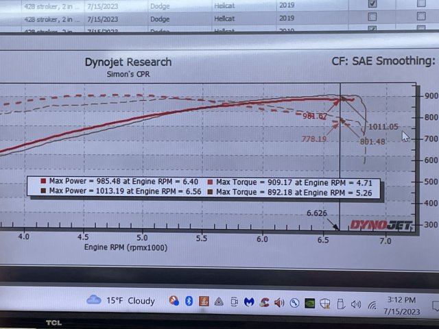

Actually made a little more. But this is also a drag radials and only 17 psi

Yeah I never understood why people dyno their cars with drag radials on literally not supposed to lol

Thing is healthy, barely breaking a sweat. When’s the whipple going on?

Fake numbers.......
It has to do with the scaling of the numbers to fit everything on the graph.

I remember when my whipple made 905 to the wheels on 15lbs of boost. Torque curve looked like that (a turbo)

You’re right because a car that went 8s on the stock engine should not dyno 1000+ on a built one

So your dyno numbers are fake? 😉

Should have put LOL after the fake numbers bit.
The reason why the lines don't cross at 5252 like they have too, is because of the way the dyno scales everything to fit on the page. If we could see the left side scale and the right side scale the top line would be different for hp and torque numbers......that is why the lines don't cross at 5252.
jonx96......I know your car and tuning ability is the real deal.....gonna be iteresting how far down in the 8s you get this.
