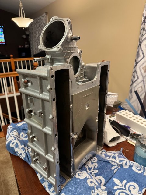

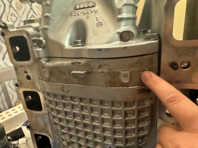

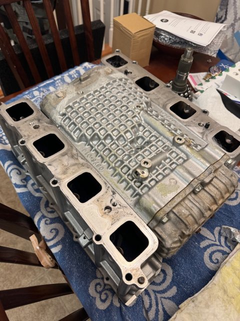

IMG_1205.jpeg IMG_1203.jpeg IMG_1202.jpeg IMG_1199.jpeg IMG_1198.jpeg IMG_1196.jpeg IMG_1195.jpeg

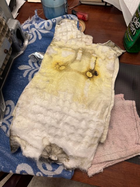

results of not cutting holes into the diaper. Did it affect performance no, did it shorten the lifespan of the blower… who knows?
Hi ho, hi ho… off to Kong Performance we go!
4,087
10,234
Thread Starter #185
To clean off the sticky and icky from the bottom, I used gasoline and then wiped it with simple green.
@fumanchu182 , need to get them vents open or your going to blow the seals out of your supercharger.
Would anything on the blanket indicate that?
YES, just use a sharp object to poke a hole and move the material back around the rounded boss. Easy peasy.
Just in case you were wondering.
Ever remove a glued on blanket? Stuff seals like Flex Tape. Send a blower in for repair with a blower blanket stuck to it and they’ll send it back to you or charge you hundreds to remove it and it’s residue left after pealing it off.
I like Kong so I took it off and cleaned it well. Gasoline took it right off.

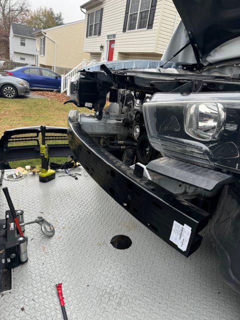

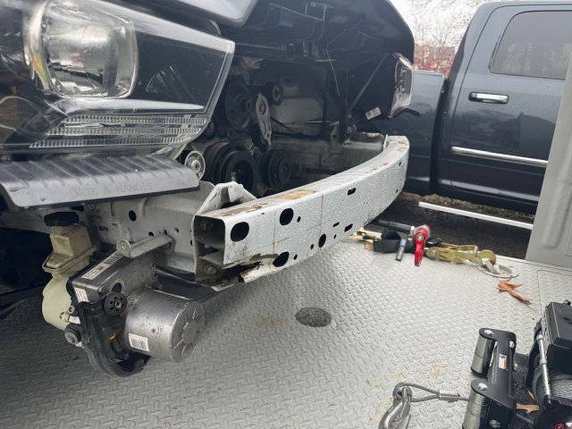

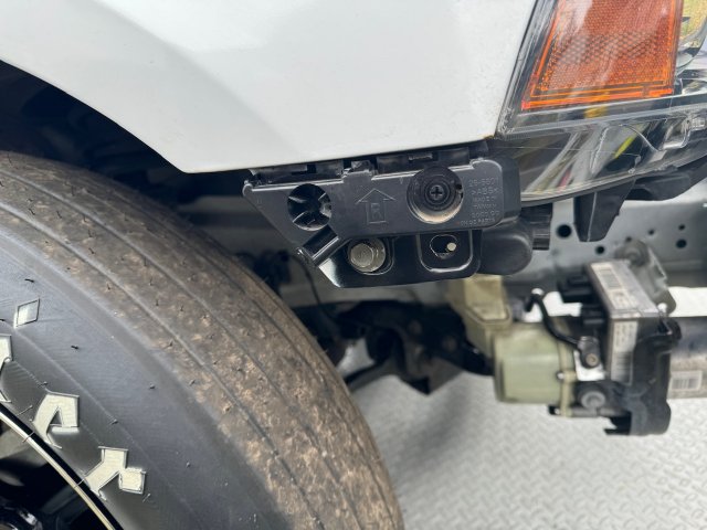

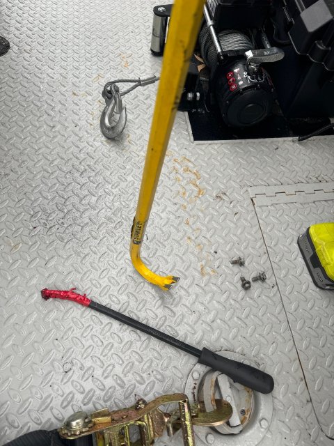

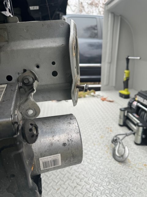

The fender is severely fcked, this was held in with screws. Did my best to get a bolt in there. Next year its getting front halved. IMG_1214.jpeg
Bumper feels 10x better and a little more rigid.

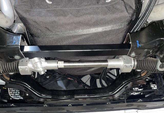

Getting there! Gotta rip out the electric steering! I’m sure someone will but that
4,087
10,234
Thread Starter #192
The flaming river setup will be purchased next month. Actually I need to do some research to make sure it will fit.

What you mean somebody. Flaming River C276DADD-85D7-4108-87C6-AF2FCAFD3F20.jpeg

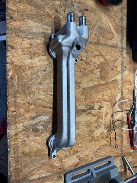

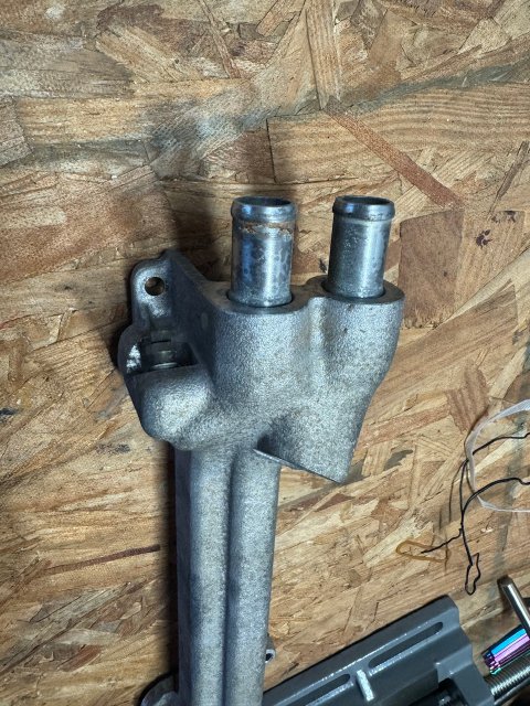

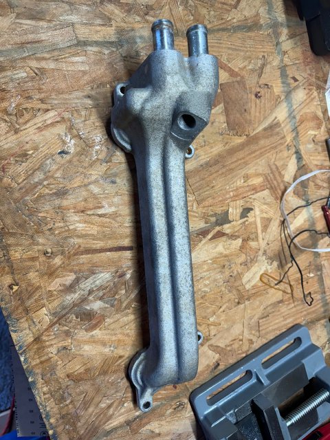

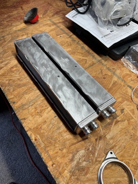

cleaned up the cooling bricks
I really have some early model parts.
After

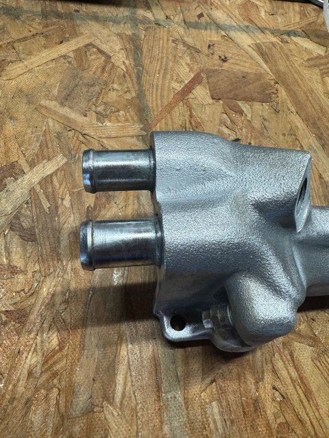

Waiting on some fittings. Those hose barbs are being converted to AN fittings stay tuned.

You have to weld in the AN fittings.
