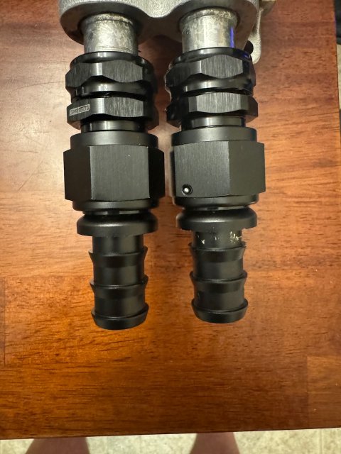

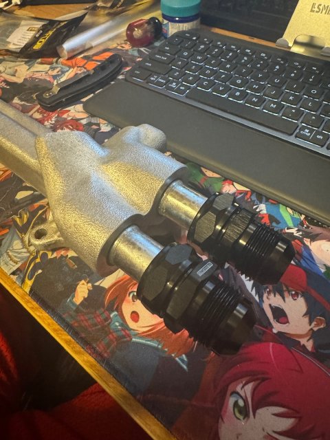

They barely fit. If the AN nut is at the right angle they hit 😂
8,560
7,506
That’s close, but hey - fitting is fitting

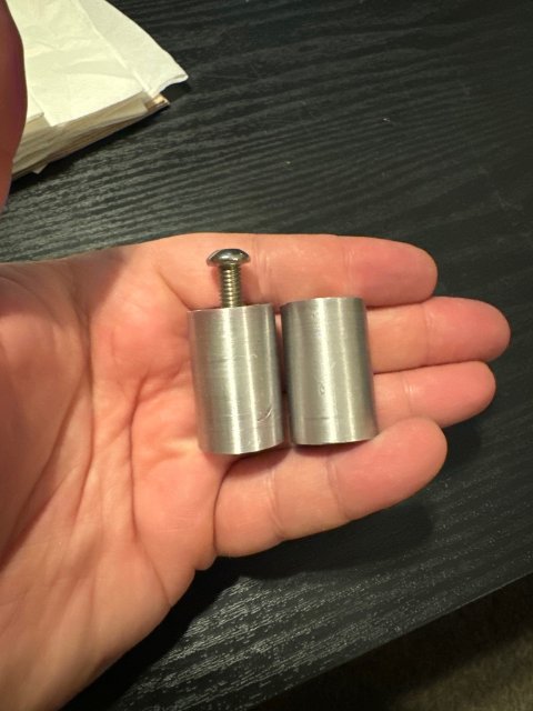

If this short gets 10k views Ill buy a lathe and mass produce these. Plugs for your water pump on the 6.2. Installation video soon.
On a dedicated race car the heater core lines are not needed, also a source of heat underneath the supercharger.

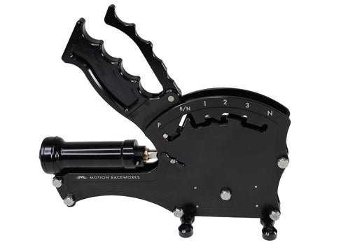

With the 400 you’ll be launching off a transbrake. With the 2-step you can set that to whatever the track condition calls for. Make sure you check out the Motion Raceworks shifter. We’ve had four different shifters (B&M, M&M, Precision, and MR). The MR is the best. The Precision is crap by comparison. I have the M&M in mine and it is nice but if I was starting from scratch it would be the MR.
100% agree this is what I ordered.

That’s the one you want (as long as you’ve got the clean neutral valve body). Motion Raceworks is a good place to do business with. And they give you a lollipop with every purchase 🤗

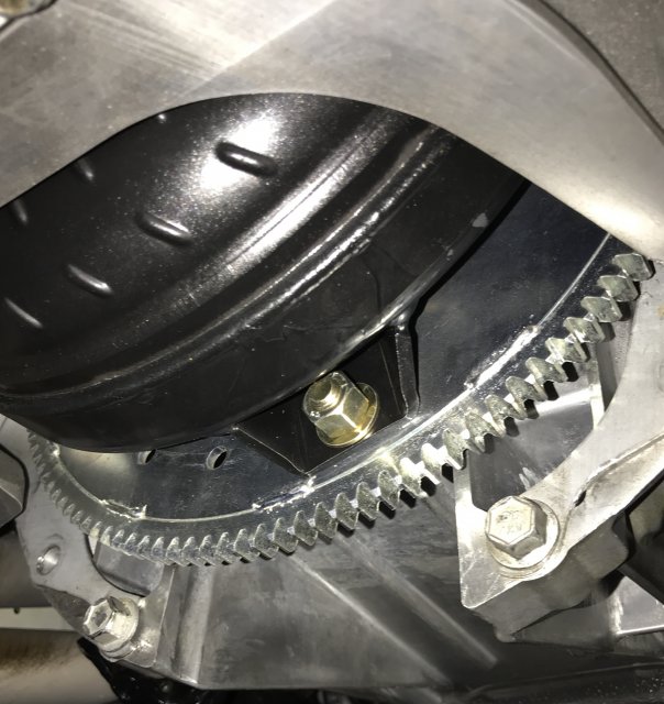

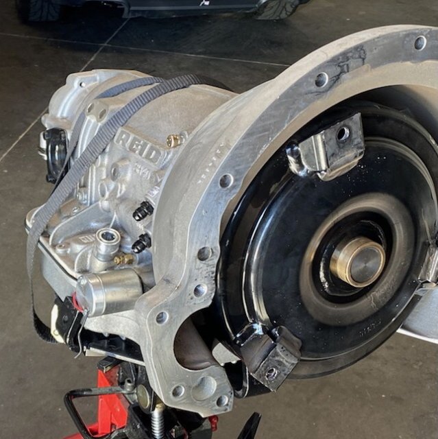

I will sell my Coan Engineering Converter and flexplate for $1000 plus the cost of shipping. It’s made for my Hellcat so should bolt right up. Stall is around 4500 and flashes in a instant. Last outing I was leaving on the transbrake with the 2-Step at 2500. It works 👊 6DEB1B42-0A6F-414E-A3D6-CAD206C47B79.jpeg 84E21E6D-2725-4178-BAFE-783BABEBDB73.jpeg

Would I get into any spacing issues with using my JW ultrabell vs your reid housing?
3,629
11,709
No. The flexplate and converter dimensions are going to be standard. The bell dimensions to place the trans where it needs to be onto the converter are going to be the same. The converter mounting holes are the standard three hole pattern.

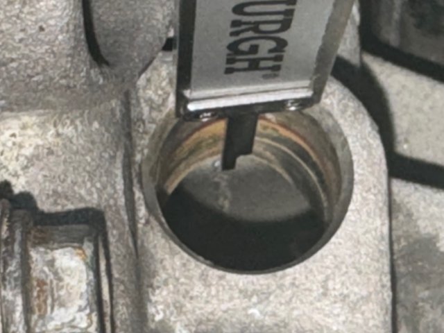

The pilot bearing/bushing isn’t a big deal. I shaved down a harbor freight slide hammer attachment to get my m6 one out
8,560
7,506
But definitely need a different one
4,101
10,269
Thread Starter #219
Huh? I’m talking about the pilot on the back of the converter that sits in hole in the crank. No bearing needed.
