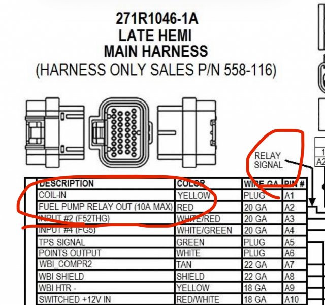

So to set the stage, I am so close to starting the car. I wanted to use the Holley to trigger the fuel pump when the car and ignition is flipped on. This seems 100% plausible as it will be going to my fuel pump relay and they provide a trigger wire, exhibit a.

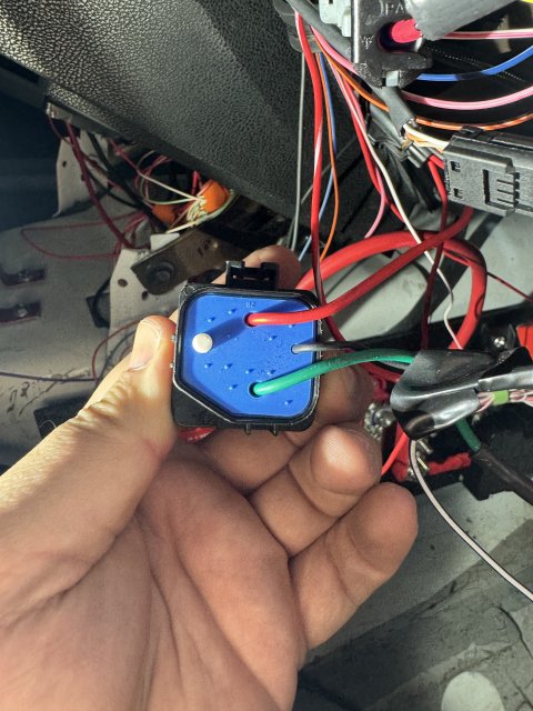

Well, I get everything wired up and get it sent to the relay in the trunk and sure enough nothing is happening. So I checked the Holley dominator configuration file and everything seems fine. Well then I start inspecting the wiring and this is where things go south fast.

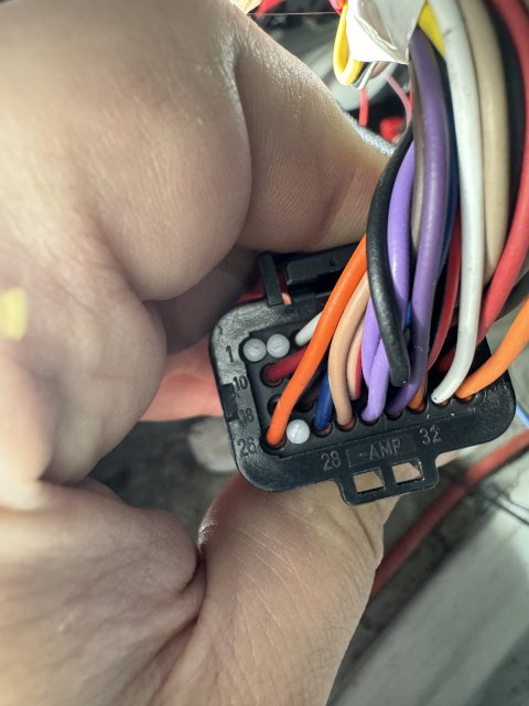

Red wire is power from the battery green wire is out to the relay black is ground and where that white plug is is where the red wire should be coming from the dominator and at this point, I’m scratching my head hard. Well, let’s go inspect the harness.
Where the fuck is pin A2?
This is where shit gets annoying, as there should be a red wire there and there isn’t so this means Holly sent me an unfinished harness and I am so livid as I can’t trust this harness because now I have to do inventory and make sure everything is correct. In the interim, I took pin a28, which is external tachometer that I am not using. And pinned it to A2. Sure enough the pumps come on, but it acts more like the old Hellcat style instead of the drag Pak and so at the end of the day it’s actually fucking useless anyway so I have to scramble and see if I have any pins and wire length long enough to go to the MSD relay. Reached out to Holley on Facebook and of course nothing.

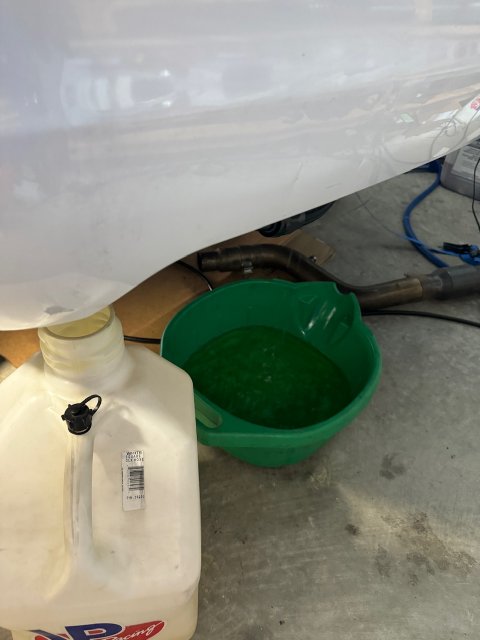

So close to starting… fuel cell leak…
draining now. Going to clean the aluminum and add more filler 😂

This caused me such headaches, I cut the stupid relay out but not knowing that the relay also powers coils and injectors. So I sat there for almost 24 hours pulling my hair out before I traced the harness again and found this information. So fuck that mechanical relay. Took pin A2 and routed it to my MSD relay, took the green line and extended it to my MSD relay. Coils and injectors came back.

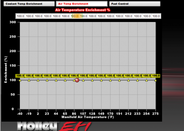

Well I'm a noob, taken multiple classes, taken multiple in person and online courses. Well they only prepare you for the real deal, not the actual real deal. So there is one table that is a multiplier of the fuel calculation.
Well this is a multiplier... And in my infinite wisdom I set it to 0 across the board so nothing interferes with startup/idle testing. Well any number multiplied by 0 is well FUCKING ZERO...
