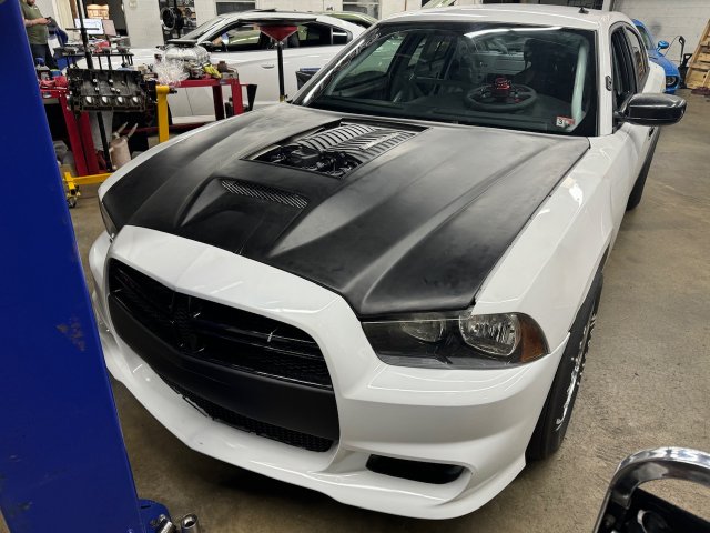

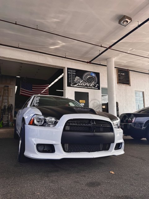

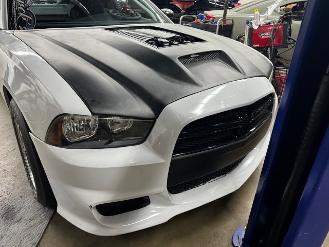

IMG_4230.jpeg IMG_4231.jpeg Hoods on and bumper is on.
Spent a relaxing day at the shop with the homies. Turned 80. We had steaks on the grill.

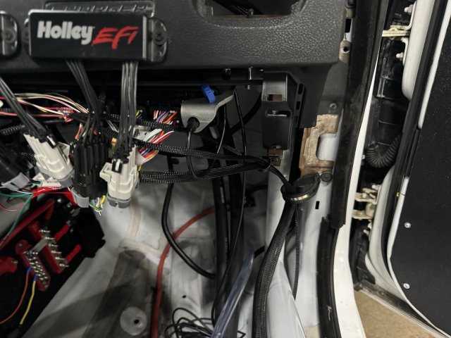

IMG_4216.jpeg And I cleaned up all the wiring that I cared to touch.

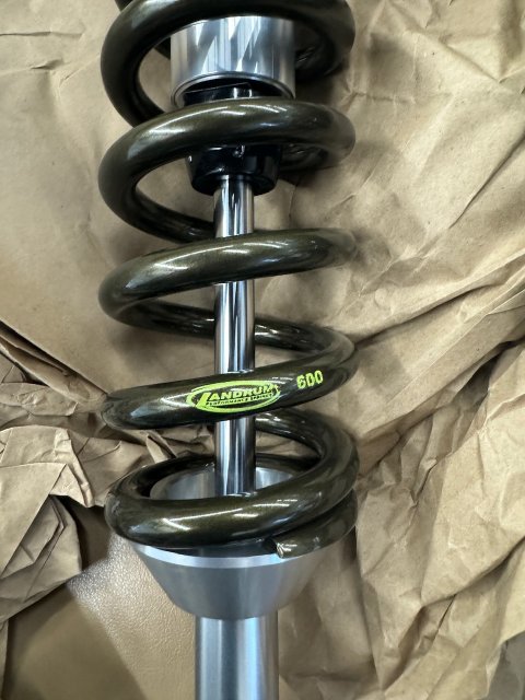

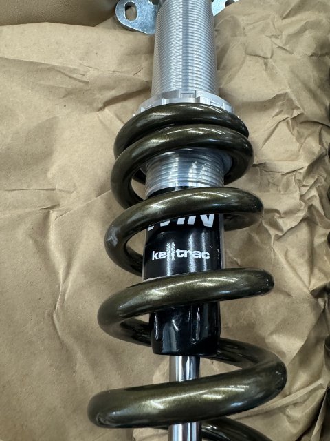

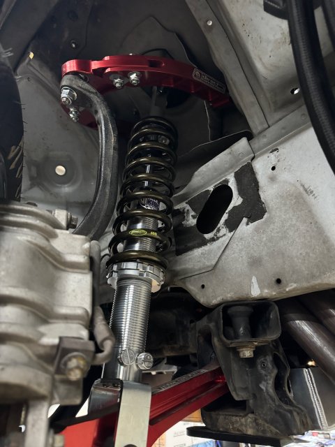

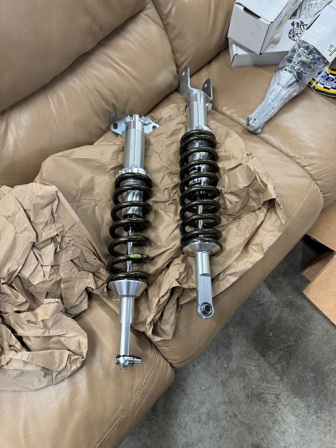

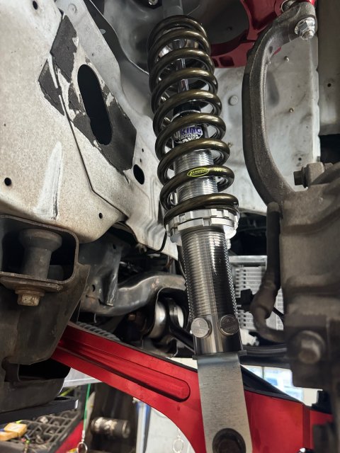

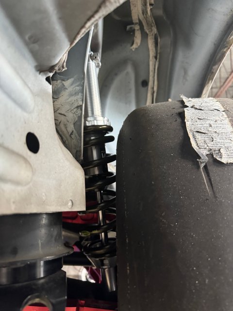

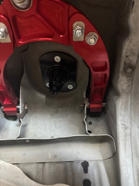

suspension is in, broke the bleeder bolt on the front passenger caliper when installing the two step solenoid… now I have to replace a caliper… 😫
3,629
11,709
Nice! Did you by any chance get a actual weight difference with AAD upper and lower arms vs the stock pieces?
4,101
10,269
Thread Starter #610
No but they are for sure lighter. My shoulders let me know this 🤣

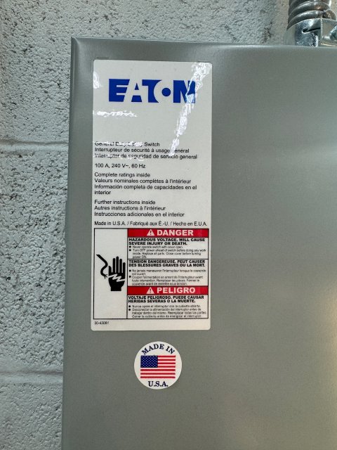

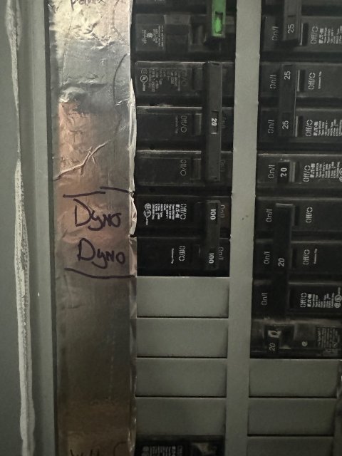

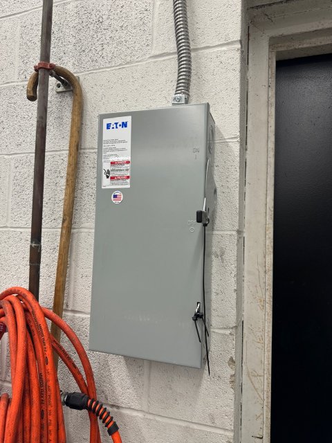

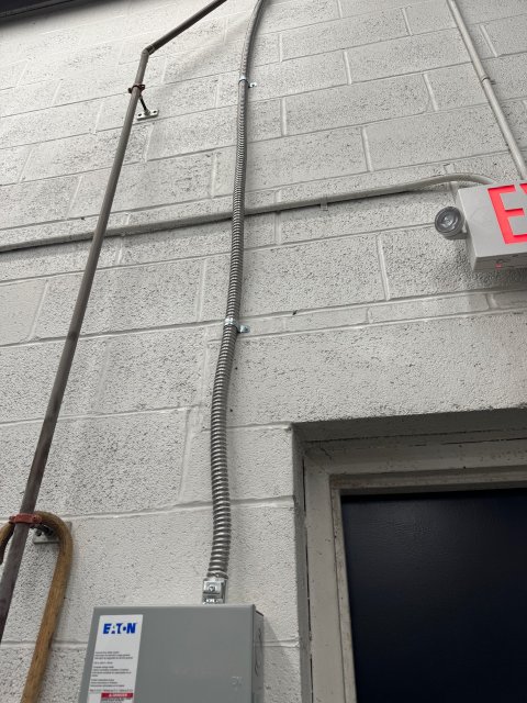

Car is on ICE. Been focusing on getting the shop ready for a dyno and buying equipment and getting electrical ran. Of course all this costs money so the race car is not a priority.
Have to spend money to make money. I will be at MSHS but in the Mopar car show with the hellcat. Once the dyno is ready the first car will be my hellcat. Second car will be Mikes turbo Challenger then I get my race car tuned and ready for battle of the brands in November.

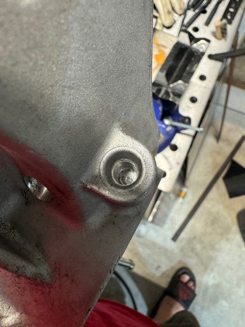

Kind of disappointed car wasn’t ready for MSHS. Time/energy/money are at an all time low so its been a slow process. However the R&D continues.

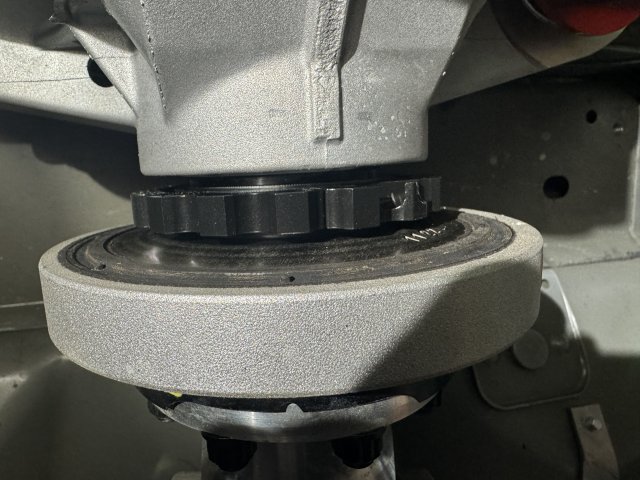

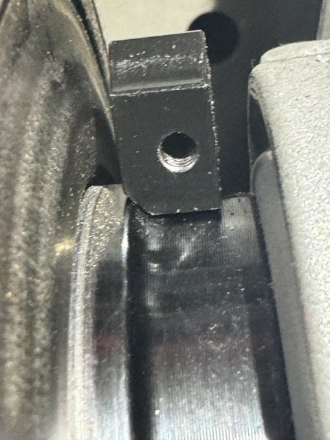

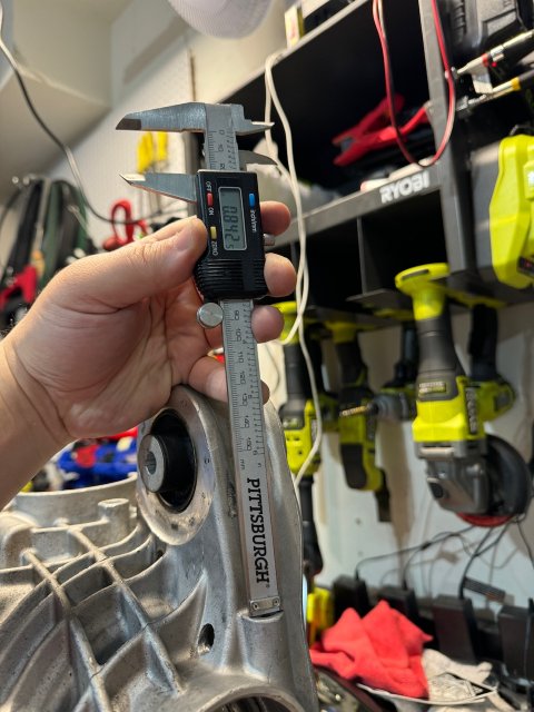

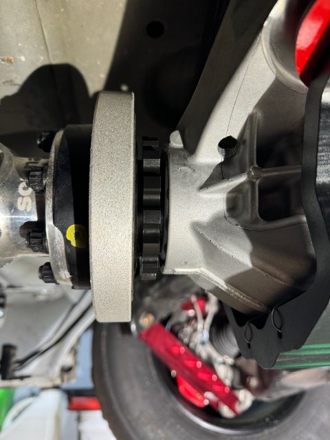

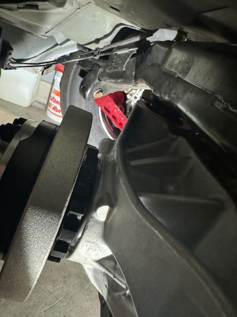

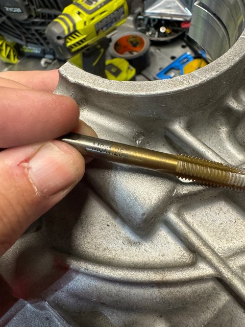

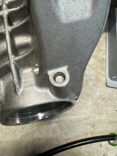

This casting mark is where the hall effect sensor will have its bracket mounted. Million dollar question whats behind it?
just more aluminum, drilled and tapped for m8x1.25
Appropriate depth

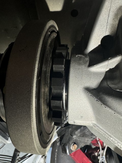

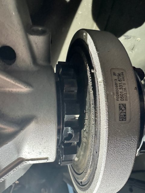

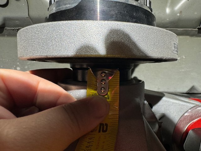

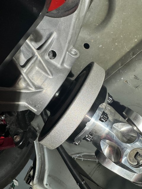

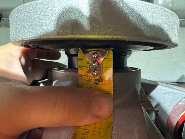

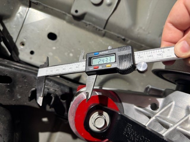

In between flange wheel and case is where a 16 tooth reluctor wheel will be mounted. Split collar. ID of collar is 2.5” IMG_4523.jpeg

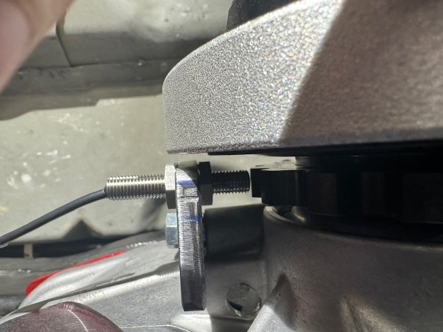

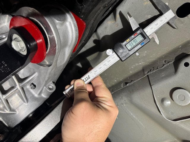

Thickness of split collar is .375”. Plenty of room. IMG_4526.jpeg IMG_4525.jpeg

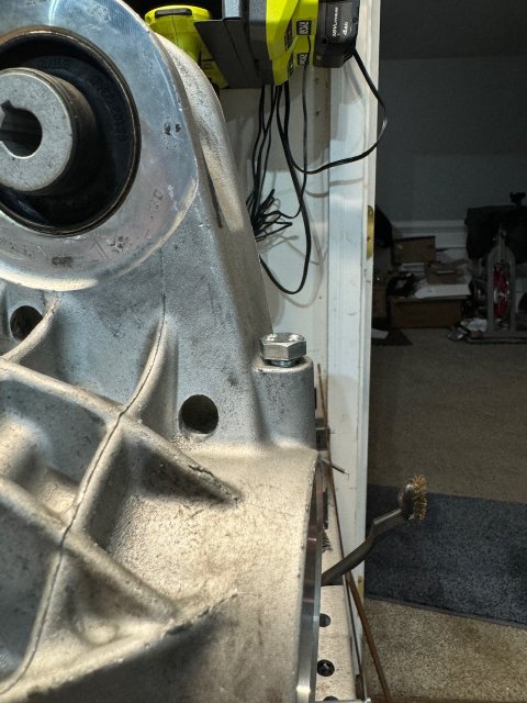

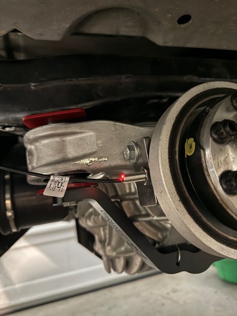

Went with low doller motorsports. 5/16 sensor due to space requirements. The Holley should be able to derive MPH and this opens the door for traction control. Easy day.

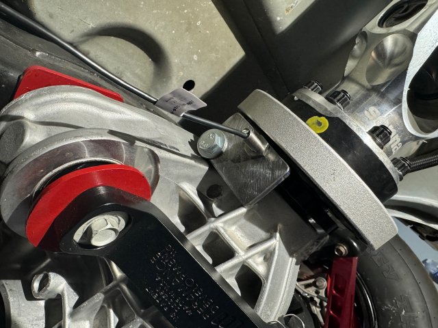

R&D continues. Very pleased with the reluctor wheel.

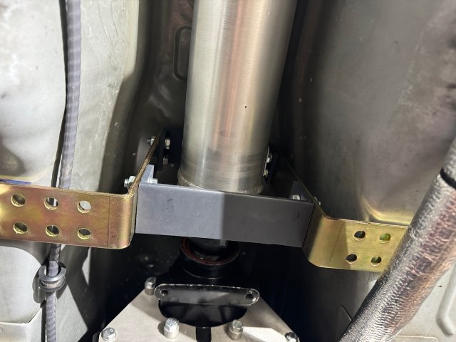

IMG_4592.jpeg IMG_4586.jpeg IMG_4591.jpeg IMG_4589.jpeg IMG_4588.jpeg IMG_4589.jpeg
Very pleased how the safety hoop came out.
