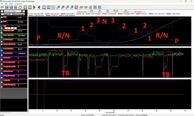

Thread Starter #641
So after taking multiple showers in ATF. Refilled the transmission and did a fill procedure. Everything is looking good now. This was me just rowing gears stationary in the garage. I will get it on my dyno next week and give it a shot. 2-1 didn't drop line pressure so I am worried that indeed there's something funky. Who knows? The dyno will let me know.

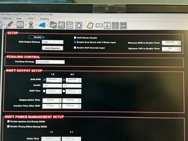

Thread Starter #645
Still getting jiggy with it. Might have a private rental on Monday
Holley has a new transmission ICF I am learning to tune.

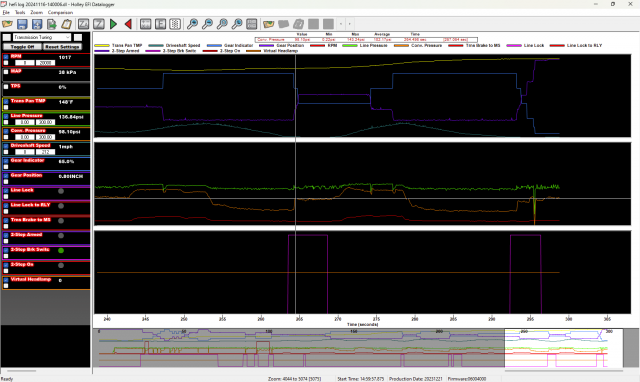

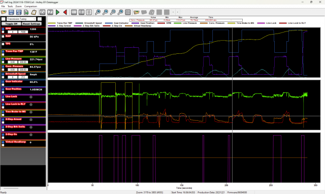

Thread Starter #653
Filmed like a potato on this one. Good news 848hp/752tq.
Bad news, possible boost leak. But hey that's part and parcel for building a race car.

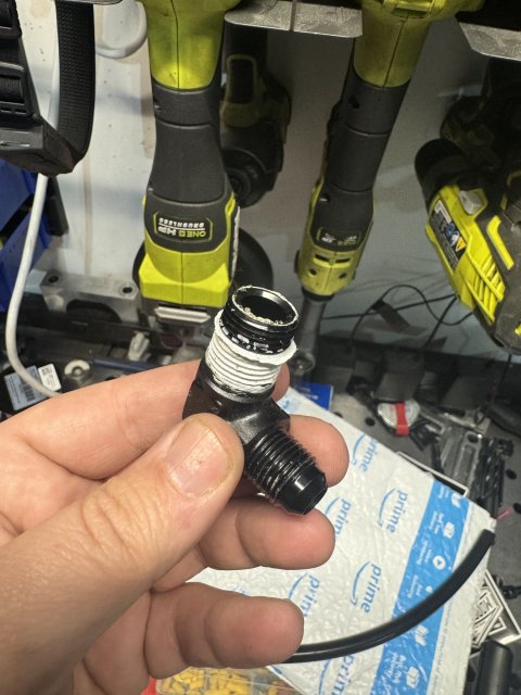

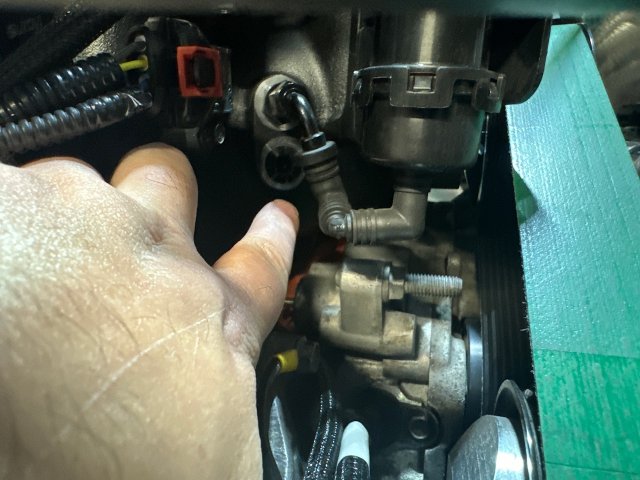

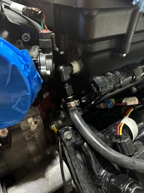

Thread Starter #654
Think we found the boost leak. Lets just say my brake booster is probably feeling some way…
pulling vacuum from here
well thats a runner post rotors will all the spicyness and its going to my poor brake booster. Would explain why the brake reservoir cap is always seeping… im going to pull vacuum from here…
just waiting on some an orb fittings
8,560
7,506
Brakes must have been tight 😆 yeah, pull from the intake track on the snout if possible. my 4.5 whipple had me take the vacuum from the back of that hideous rear intake elbow pre rotor

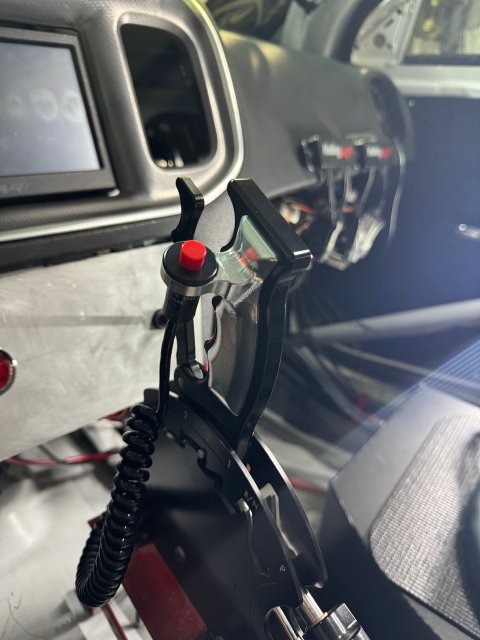

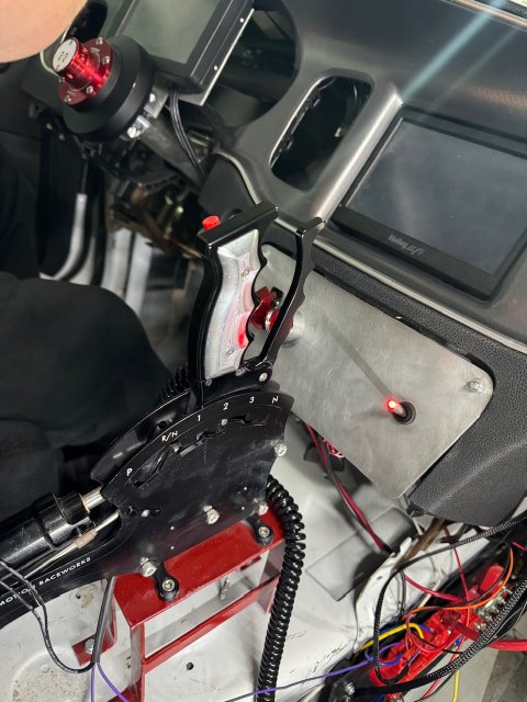

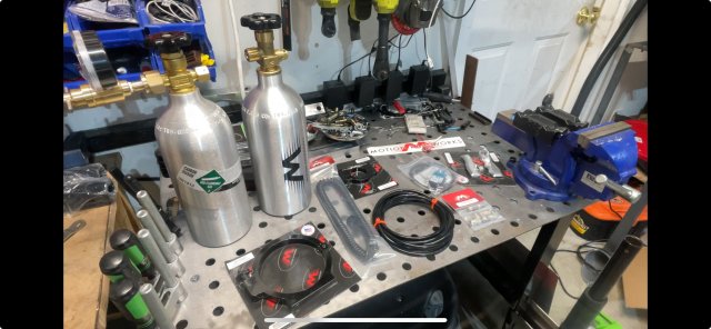

Thread Starter #656
added some bling, also have decided that since I have co2 i will be using the transbrake as well, will be testing on the dyno soon.

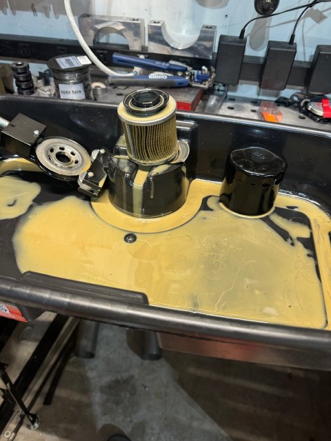

Thread Starter #657
Car idles 100% better. Must have been the ptfe paste I used and just basically never did shit.
First oil change.
No I don’t have a headgasket leak. E85 contamination. Catch can was bone dry. Might need to change that.
7,428
19,511
Wow what caused that?
4,101
10,269
Thread Starter #659
Many factors such as worn rings or potentially too long of a line for the can
7,428
19,511
Isn't the motor new or am I lost in the thread somehow? I'd suspect too much injector or something.
