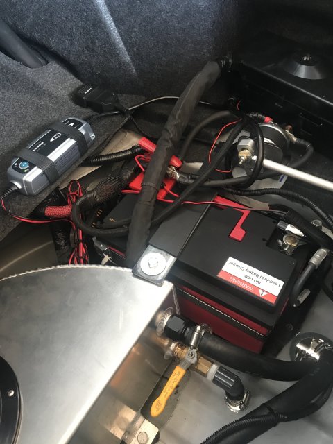

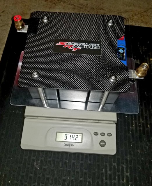

I have had this charger for over a year now. I use it in the winter 100% of the time as my Hellcat sits in hibernation. I have it mounted next to where the car sits and I installed the quick plugin that comes with the charger under the hood. During the driving season it's not on the charger much and I've never lost a charge on that battery.
CTEK (56-926) LITHIUM US 12 Volt Fully Automatic LiFePO4 Battery Charger https://www.amazon.com/dp/B00EUF6UM8/ref=cm_sw_r_other_apa_i_CBITEbPM72QTM
Octanewide
#988
968
1,801
House of power
@Octanewide
Is there a recommended trickle charger to run with the DCR battery? I see they have one on their website, but I wouldn't want one permanently attached to my car. How long can your car sit before the battery would be dead? Mostly I just drive my car weekends (Also stored in winter).
Here is the underhood charging hookup for that ctek charger.
