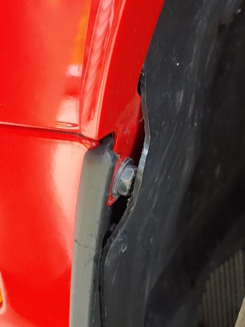

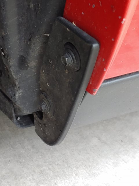

Rear bolts

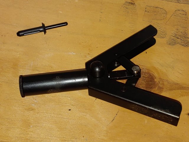

Tool

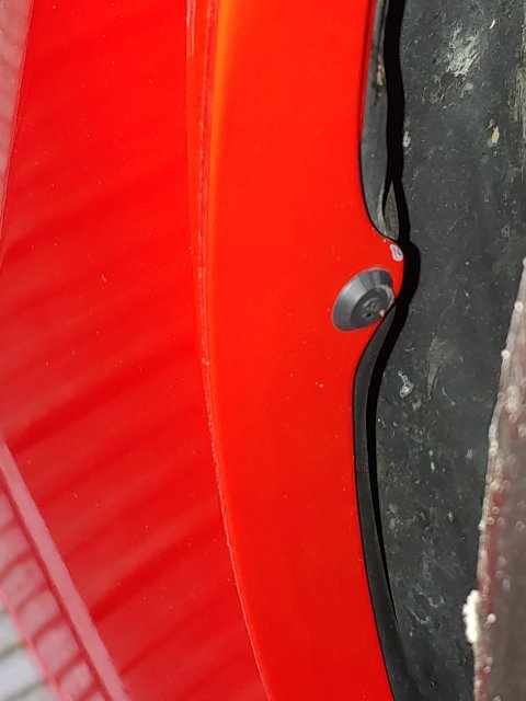

And an installed rivet.

Dang it. Just noticed paint chip.
Caused by bending tab back after NOT drilling original out at first.
Easy touch up. No one would notice.
